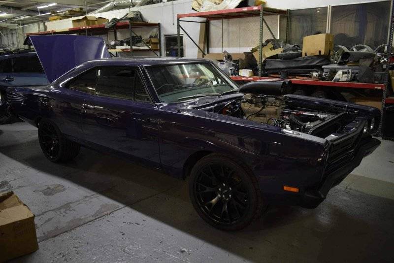

New member but have frequented this site several times over the last 3 years. I started building a 1969 Roadrunner. Car came with a perfect body. A 440 and a 727. Seemed simple enough. Put the motor in the car with the tranny and go!
Well 3 years and tens of thousands of dollars later, I finally thought today would be the day that I drove the car. Once shifted in R or D, the car shuts off completely and sets my dream right back to square one.

Welcome to the jungle... Car looks sweet, Little old school hotrod flavor.... Now it's time to get it running sweet... My first thought is electrical, maybe a bulkhead connection or a fusible link....
Actually after re-reading I take that back.... Set the rear axle on jack stands with the wheels off the ground & try putting it in gear with the brake released....

Welcome from CT. I'd look at neutral safety switch/Linkage adjustment? Temporarily bypass the NSS by grounding the wire on the relay. Don't drive the car like that!!

Nice ride. If the car runs and sounds good in park or neutral then you shift to D or R my guess something electrical.
Nice project
Welcome from Alabama, a brighter picture would be nice, but won't make it run better.
