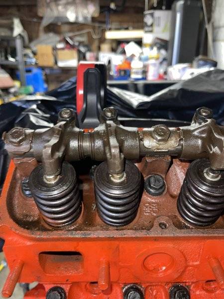

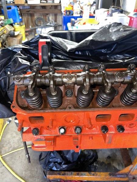

I have a couple sets of the Isky ductile iron rockers
I put a set on my 440 so I can measure for pushrods but they don’t line up right on the top of the valve. Am I missing something or do I have to modify the hold down.
Isky rockers were designed for the pre 64 head. Heads with cast in rocker stands will need some attention.

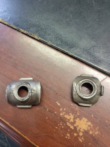

Interesting. So I took a look at some iskys I have here, low and behold, the hold downs are indeed ground to fit.
These are Cranes but I "modified" the hold downs and also used spacers, washers and shims. I don't remember the clearance needed anymore between each set.
I only recall having to grind down the two tabs on the larger spacers but that was quite some time ago...
They make various size shims to push the rockers over...takes time and patience

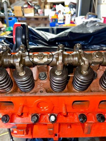

You need to grind the hold down tabs off. The lower portion of the rocker body may contact the cast pedestals. Use a thin shim between the rocker and pedestal and hold down. It will be close enough then.

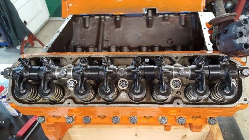

The Iskys I had were shimmed and the springs were not used. Also the rockers had a hardened pad at the tip and were wider than those or Cranes. I also used 440 Source hold downs. Old school with a solid cam good to 7500 and bullet proof.
I've machined quite a few sets of Isky's I intentionally cut them slightly narrow so I can use a shim between the rocker & the rocker stand... I made a simple jib for my lathe so I can knock out a full set in fifteen minutes....
Maybe you're thinking about the 2 outer tabs that don't have to be ground off.

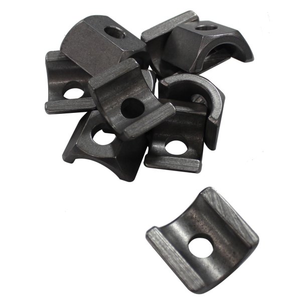

Factory hold downs are a bit crude. I used aftermarket ones then filed them for better alignment
