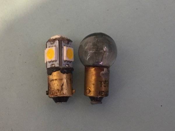

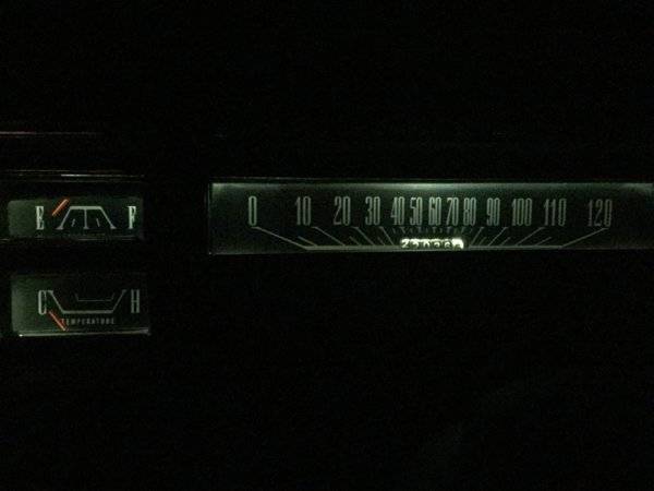

I experimented with various colors and styles of bulbs and I ended up using 'warm white' bulbs (see link below). The warm white simulates regular incandescent yellow light. When lit, the overall color of the gauges is very close to stock, but is significantly brighter (my pic does not show it very well though). The regular (cool white) LEDs saturated everything blue - I didn't like them.
Also be aware that the LED bulbs don't dim much, and they are polarized, if they dont light up, remove, flip it 180 degrees, and re-install.
Lastly, since one of my dash bulbs were the bayonet type, I had to jury rig one of the bulbs on a cut down bayonet base to get the LED to fit.
https://www.ebay.com/itm/8X-Warm-Wh...916113?hash=item3f5578be91:g:kHEAAOSwfsFZcEj2
definitely good info you shared, but I wanted to point out that flipping a bulb 180 won't flip the voltage polarity applied to them

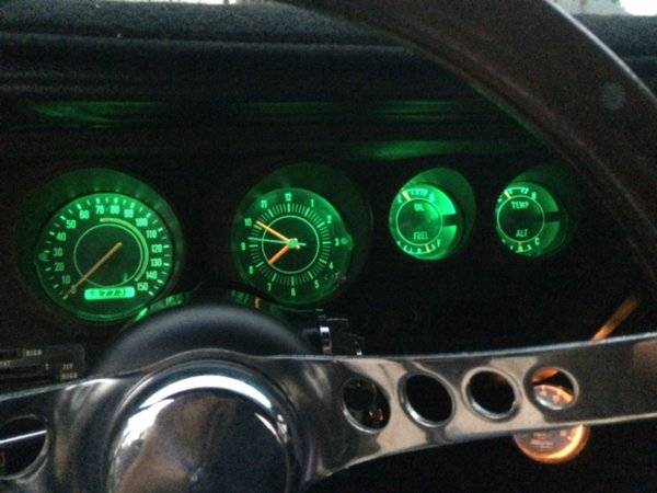

I used blue ones from fleabay on my 67 x and I like them they look cool did not care about the stock look they are polarity specific had to flip them 180 I saw another member with them and had to have them
