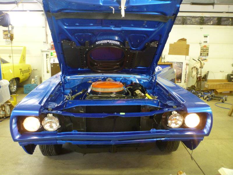

Low beam..

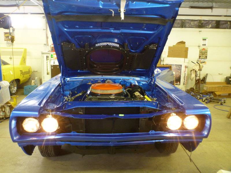

High Beam..

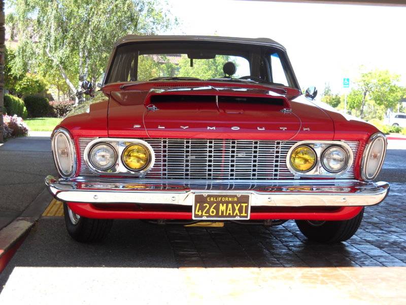

Yellow fog lights like these? 5 3/4" GE bulbs for export. Bought on ebay...

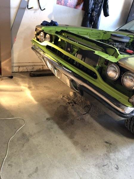

Just set up the lights. All three looked like 1968 bulbs except for the halogen I got today. At some point I might upgrade with a couple of relays at the mininum. Pic work in progress...
I don’t like modern headlights on old cars. I run halogen sealed beams on my 67 coronet and they actually works quite well, better than headlights on a lot of the other cars I have. but the Hella h4 European conversion lights work really well also. and yes I have yellow fog lights in the center high-beam. The outers are hi-low
