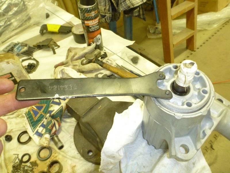

The procedure is in the FSM. You need a big/special spanner wrench.

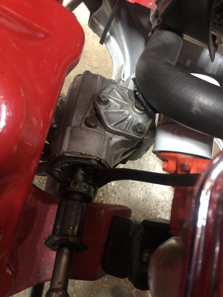

Angle grinder spanner works perfect...

In the car... BIG channel locks (or a punch and hammer) loosen the big lock nut. Try snugging up the bearing retainer I show above using a 4.5" grinder spanner. No cranking.. just see if there is any slop and take it out of the worm shaft then retighten the lock nut.
