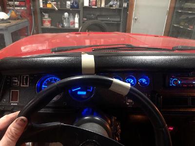

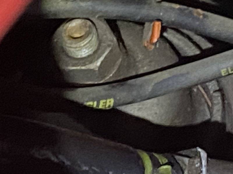

I know this has been discussed a lot here and on various forms. Ive got a 70 b-body power steering box that has probably 4” of play at the steering wheel from left to right before the box starts to move the pitman. It’s ridiculous driving it. Looking at the box where it connects to the coupler you can see it moves in and out maybe 1/8-1/4 while moving it left and right. I’m not sure if that is normal or not but I would guess not. The coupler, Column and suspension are fine. I’ve ruled out play, binding or wear in every other area. It’s obviously the box. I was going to pull it out and send it to firm feel but wondered if it was worth turning the worm gear adjustment in case somebody had messed with it in the past or backed it way off. Anyone had luck doing this with similar symptoms? I figured it’s worth a shot. I have the FSM and read the stories of it locking your steering if going too far on the adjustment. I’d post video but I don’t have it hosted anywhere for a link. Photo attached. Is the adjusting screw usually that far up above the lock nut on these? I just wondered if might have been backed out too far from someone in the past.

It doesn’t seem to make a difference running or not. I’ve looked at it both ways. The travel in the gearbox is about the same either way. Off season here so I haven’t driven it in months. Looked at it today but not running and I’d say it’s more than 4” if you have you hand on top of the wheel and move to one side before movement at the pitman but you can see the coupler and gearbox at the connection moving immediately.
You can try to adjust it. Mark the threaded part and keep track of your adjustment. Crack it loose and tighten the screw 1/2 turn and try it. Keep doing that and see where it takes you. Knowing how far you went will allow you to go back to your starting point if nothing helps. I will just about bet you have play in the steering some where besides the gear box. But not knowing its history it could of been set wrong at some time.

just like everything else on these cars, everyone has a different experience. I ran into a problem with the sector shaft adjustment ( the one you have pictured ) leaking. I had to pull that part of box apart and replace a few seals . Doing so really allows you to understand what is going on inside the steering box.
To put it as simply as possible that adjustment , is to take up slack between the teeth of two opposing gears. With regular wear and tear the teeth get worn over time , which cause the " slop" . The actual wear in the gears is very small maybe 1/16 but when that is transmitted threw the rest of the box it amplified considerably by the time it gets up to your actual steering wheel . Thats why it is recommended only to make 1/8 turns of that adjustment screw , it doesn't take much !!

Well you guys were right despite me doubting it. Ha! I spent more time with a helper checking it out more closely. Idler arm has a lot of play and the pitman connection at the center link has a bunch of play. The nut isn’t even that tight but the cotter pin is holding the nut in its present location. I am relieved to think that the steering box might be ok or at least what I consider the usual mopar PS feel after I replace these parts. While the car is running I did notice the play in the steering wheel is dramatically reduced than when the car is off and doesn’t take a whole lot to start turning the wheels. I thought I checked that already but apparently not. Duh! Easily fooled by decent looking bushings etc doubting there was a suspension issue and looking it over too quickly the fist time. Thanks guys!
