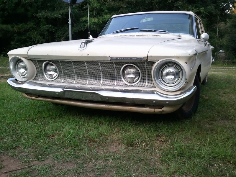

Hello everybody, I'm glad to finally be on this amazing web site. I joined because I need some help with my 1962 Plymouth Belvedere. I traded my Toyota for it; the guy recently found it in a barn. It is all original and surprisingly came with air-conditioning. I have been working on the 225 slant 6. One morning it refused to start and hasn't since. I am getting spark and fuel. I have also been playing with the timing. Hopefully I can find a resolution on here.

Sweet barn find dude....... And smart trade......:icon_salut:

Hi Carhunter, welcome and thanks for joining. That car looks mean from that angle!
