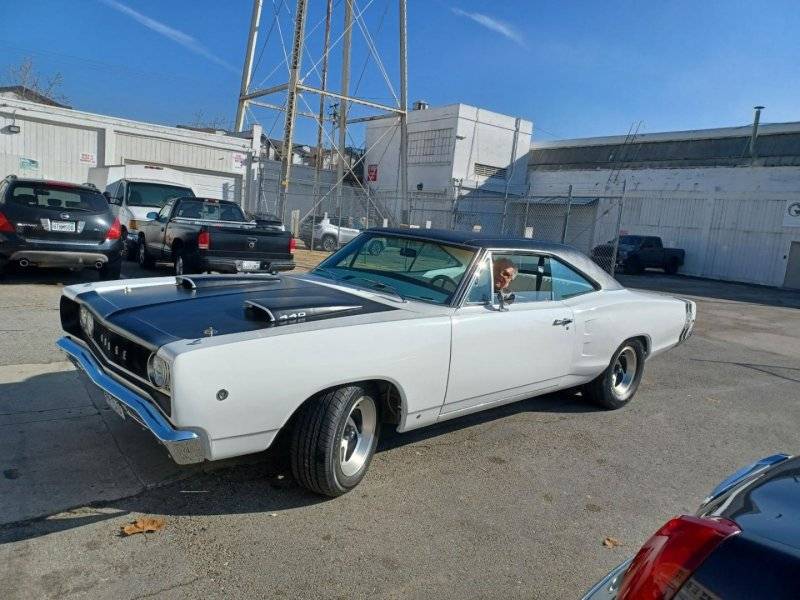

Mine is a 1968 Coronet 500 440 TF727. It came with air shocks when I bought it but had no air lines. I installed new lines but I do not like the ride. Do you think it's best to go back to normal shocks? I am thinking yes.

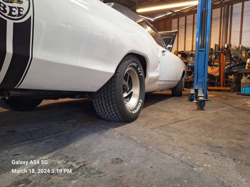

You are better off getting the best springs for the desired ride height and ride and then quality shocks.
Great advice. The springs are great. I'll order some stock shocks.

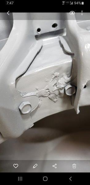

Good decision. If your coronet is the same as a roadrunner the cross bar on the top of the shocks is not designed to carry the weight of the car and they have been known to punch through the floor of the trunk.

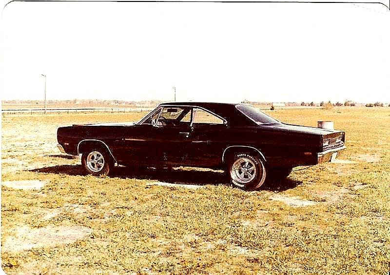

As for the wives tale of air shocks destroying the upper mount... that mount is about the only piece of the bottom of my Bee that was saved and reused. Air shocks since 1979. Just smart enough not to run them at 100psi...
Air shocks with just a few pounds of air can transform a car. Maybe I'm getting old.
Shock mount repair I found after media blast on my 69 RR .... most likely from jacked up air shocks.
