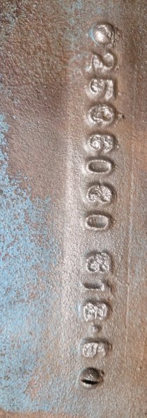

Hello I have a 1973 Charger the vin is 43441 but the engine and transmission numbers are 43331. I am wondering if this is original. I find it hard to believe that someone swapped out the engine and transmission with that close of a number. what do you think?
Could very well be original. I've encountered mis-stampings over the years.
Maybe, Maybe not. What might help is knowing the build dates of the car and motor.

the door tags says build 5-73. here is a pic of the engine
Does the title match the dash VIN, Fender tag Vin, Door VIN, Build sheet? Then the date codes on the motor and transmission. All this will help to make a decision.
