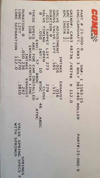

If most of your cruising is 55mph highways and back roads, the 3:23 is a nice all around gear. If you do a lot of freeway cruising, the 2:94 might be better. As someone else said, if you have both, try the one that's in there and see how you like it. If it seems doggy on your cruises, change it out to the 3:23.
This. I had 2.94 in my 440 car and thought that they were fine and would do it again, and I don't do a lot highway driving. The motor and cam matters.
