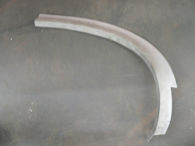

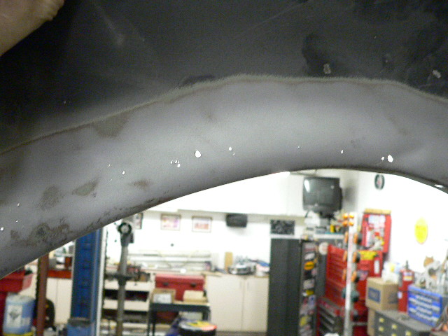

If the holes are from rust make sure to get it all. If there from wear then just weld. Go slow, Don't chase the hole if it burns through let it cool and go and. DO NOT BLAST! It will warp. Copper works good. I like higher heat with a quick touch. It can be done. I filled over 50 holes in my wheel lip patches where it had pitted from the inside.
Doug
Doug
