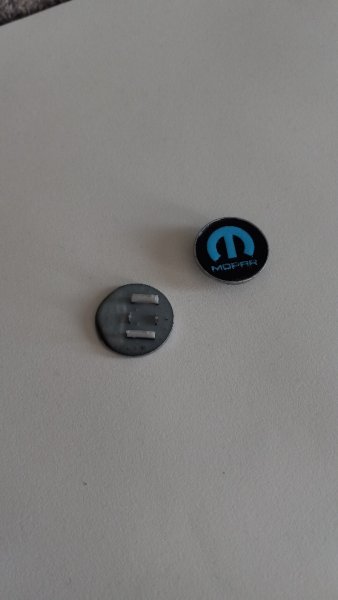

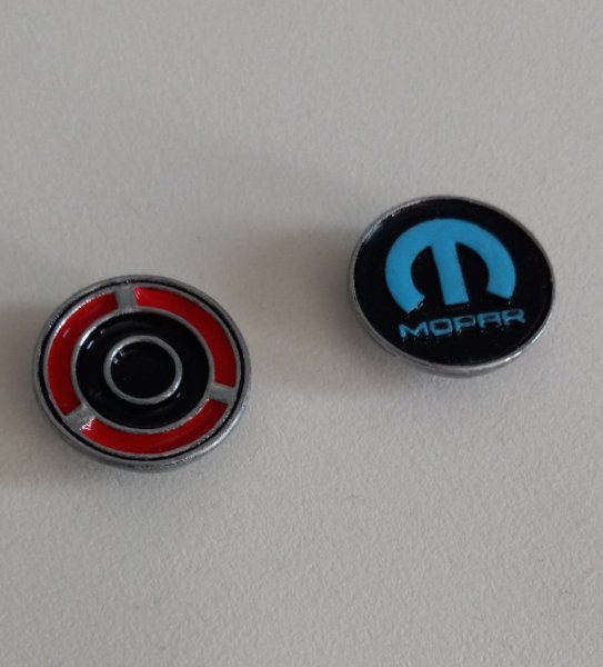

Always thinking of new things to make with my 3D printer.
My latest little project was the dash emblem found in the center of the cluster.
I did one that was close to the original Charger " bullseye " and then made a mopar one just for fun.
Painted by hand , it's tedious but I'm really happy with how they came out.
They snap into place just like original

What is the material its made of and what is the final finish like ?
The material is a polymer resin that is cured with UV light. Once it is cured it very much like ABS or other plastics. You can buy resins, based on the characteristics of what your making. For these little emblems as well as Hood mounted blinkers that I make, I use a mixtures of 2 resins, that give a strong, yet slightly flexible finish, and then mix with another that has a heat resistance ( approx 130*C- 266*F ). The parts will never melt, which is another characteristic of the UV resin, but will get "soft" under extreme temp.
I am an automotive painter by trade. So I give these a light coat of 2k sealer, spray them all black, then use a brush to add the red and chrome. Finally they are clear coated. SO to answer your question the finish is like any plastic piece you would see on a car.
