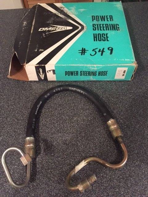

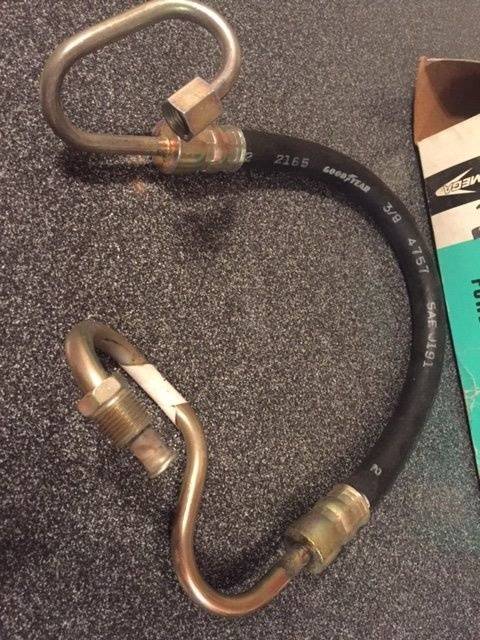

Can anyone help me with finding a power steering hose for the gen 3 pump to the factory steering box? I have checked my local shops and no one can make the correct oring fittings. I can't find anything for a stock steering box on bouchillion or Mancini either...
I have this hose for sale, not sure on the application...........
