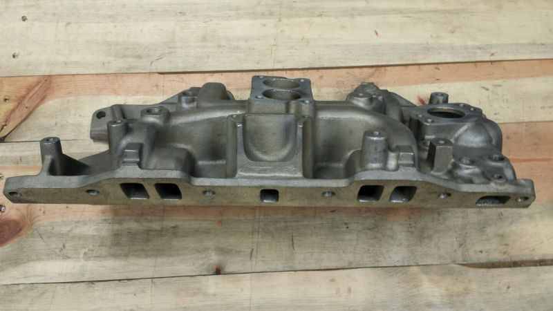

Finding your stock 4 barrel that matches up to the heads is great, but you must take into account that the 4bbl 318s that started in 1978 also had 360 heads and cam, which is why they shared part numbers for those components. That manifold may not have the same flow on an earlier 2bbl head 318. However, a 66-68 273 four barrel intake would match the 318 ports fairly well.

1) The OE 4bbl. is actually a good intake manifold that should be able to be had on the cheap. Blocking off the EGR valve, IF it isn’t on the i take already is a simple home cobbled steel plate and correct high temp gasket. Inside the intake, of the 2 floor jets, 1 can be screwed out and a Allen head flat plug can be installed. The other floor jet may or may not be the same. If the floor jet is a simple cast in hole, a quality epoxy can be used to plug it up. Now the intake is as good as the earlier70’s units.

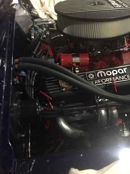

No coil mount on the intake. I fab’ed up my own 6 pack like bracket and used an epoxy coil. (See below)

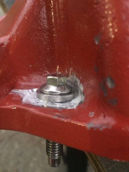

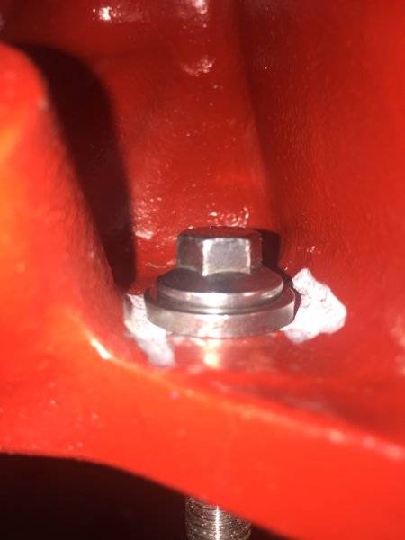

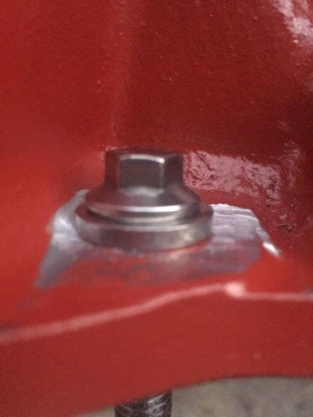

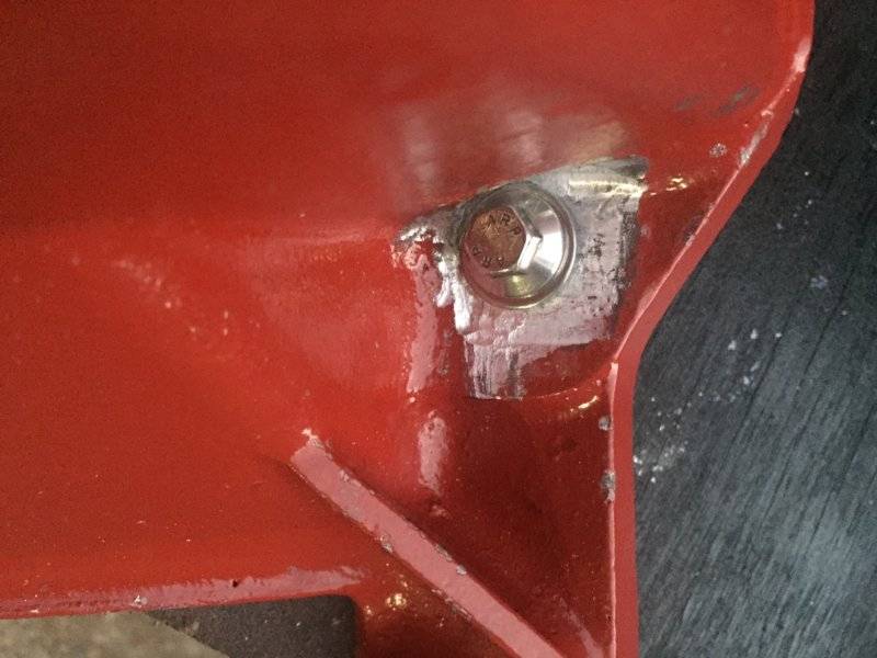

(2) I had to grind away on the outside runners to get the bolts next to the runners in. This could be due to them being ARP hardware, longer bolts than stock? IDK for sure.

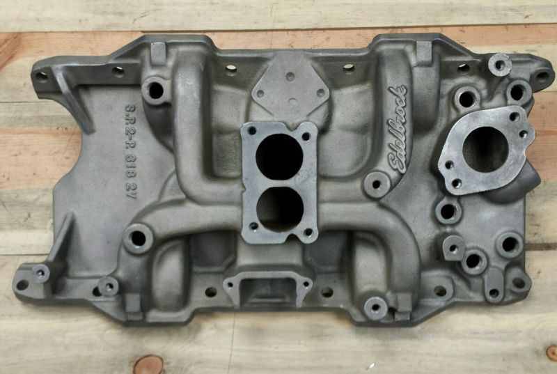

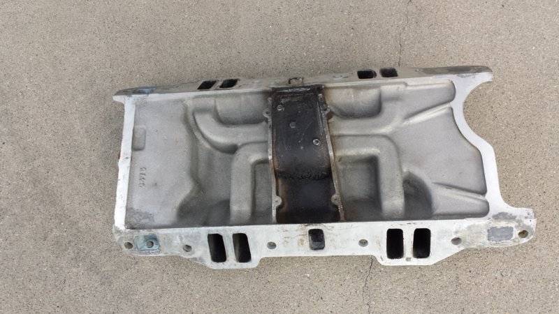

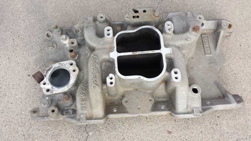

Below is the sp2-p (318 2V) by Edelbrock in the 2bbl. version.
The Weiand Stealth below. Note coil position.

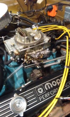

I have a 318 in my 72 Satellite, that I found a 1981 Dodge Diplomat 4 barrel 318. Got the intake, and it matches up great. Put on a 390 CFM holley and runs great. Getting about 20-21 MPG on the road.
Nice job. I personally would have used a 600 cfm carb. I’ve done this with an Edelbrock LB4, *I Think* it was. I’ll have to check that.... but any ways...
What ignition do you have?
Headers?
Single or dual exhaust?
Pipe size?
Gear ratio and tire size?
IMO, I think you can get a little more mileage out of this engine.

I used the 390 CFM Holley because I wanted the 4 barrel look but the 2 barrel MPG. Took off points, put on Mopar electronic conversion, duals off stock exhaust manifolds, 2 1/4 pipes, 2:71 rear gears in 8 1/4 rear. Sounds and looks great. Don't get me wrong, I had other set ups on the car, 650 Edelbrock and aluminum intake. It actually had more power, and louder, but got less MPG. I am going back to as close to stock look as I can. Pulling mopar valve covers and air cleaner and replacing with stock ones and dual snorkel air cleaner.
