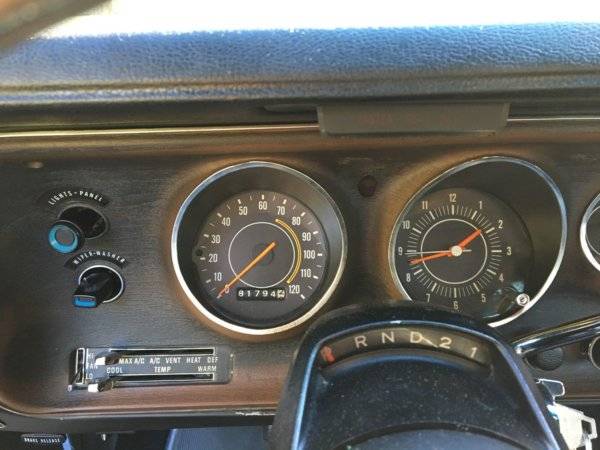

On my 1973 Roadrunner, on my gauge cluster I just have the clock instead of the Tach, can I replace the clock with a Tach gauge, where and how would that change the wiring then, also if possible where can I get a Tach for my cluster at

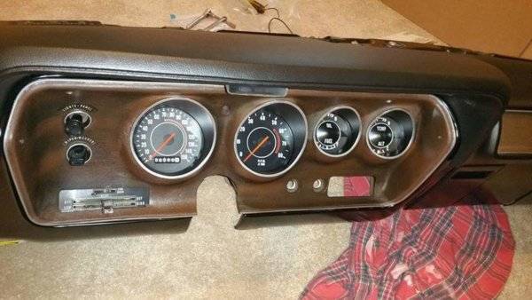

Here is mine:
