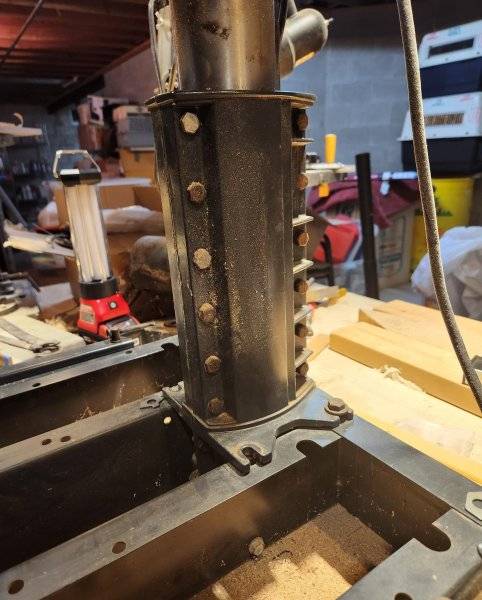

I posted a thread on this back in 2019 and given my issue now, thought I’d post a new one. I have a Craftsman 10” saw that’s maybe 45 years old, it’s the model that was issued a recall to obtain upgraded guarding and later, a small payment if you disabled the machine, no longer providing replacement parts.
I rebuilt the guarding for it and has worked well the past few years. Here’s the hassle: I’ve been unable to get a level cut. I had gone through the adjustments and seemed as though I passed, but nope. The table is square, fence square, blade square. Unlevel cut remains; farther travel drops the blade cut.
The arm, far as I’ve checked it so far, isn’t showing level. Yet, there’s nothing about leveling it other than ensuring the column and all screws are tight sifting through all I could find on adjusting these saws. Bought it in 2019 and it had sat for years unused. Don’t know if the arm might have been smacked at one time. Nothing appears damaged. All I can think of is maybe shimming the column post with washers once I figure out what thickness they would need to be.
Yet, after a long search, can’t find anything like this being done or recommended as an adjustment. If anyone has run into something like this finding a fix, would greatly appreciate hearing. Thanks much!

one of 2 things come to mind that could be the issue.
1. The arm has play in it causing the power head (blade) to drop the further out it travels. This may not repairable.
2. The table is not parallel to the arm the full length.
So why not adjust (shim) the cutting table to match the blade downward slope?
Yes I have a few other saws and don’t use this one much; but not finding anything on arm adjustments, including some forums on these machines, prompted me to ask here in case anyone of the shop types might have come across this and found a fix. As I’ve been pondering on it, shimming the front bolts might be a trick as I have a level table and the arm isn’t. I’ll see about trying to find an alignment playing with the table before I get into arm. Yeah, I could buy a new saw; I just get stubborn before giving it up, lol. Thanks.
Lol, this will interest nobody; but me. Bugs me when I find posts that never has an ending so I try to have a The End on mine. As mentioned, I found nothing other than a reference to leveling the saw column. Everything is about table leveling and adjusting the arm to the table using the spindle with a gauge. I had done this, though the arm was sagging a good ¼” with the table level. So the deal would be to try to unlevel the table to match the unlevel arm. This bugged me too. I found two washers in my stash of a 1000, and inserted those under the arm to raise the column (where the two bolts have been removed). Not a fast deal given the weight and interference with the table elevation gearing box I had to putz with. Car jack came in handy to elevate the arm to level.
Success, not perfect, close enough for what I needed. Oh, yeah – The End.

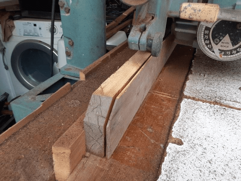

You've not had fun until you've ripped a 6 inch section from a 40 pound, 50 inch by 1 1/2 inch particle board with wood face and ends with a 65 year old radial arm saw.
...or done this-
