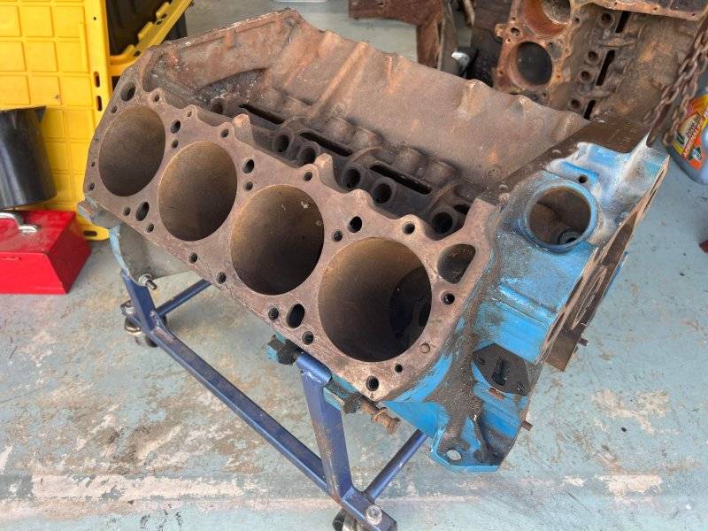

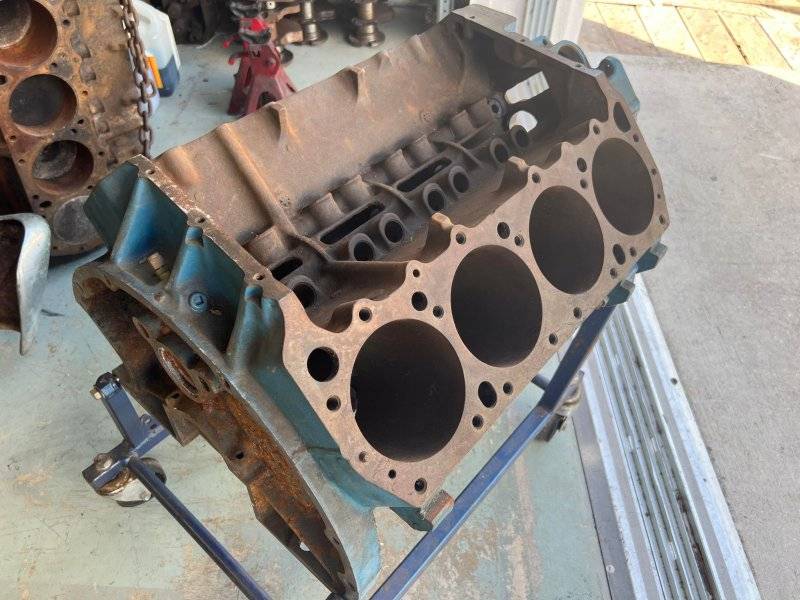

Got something cool for you guys to check out today.

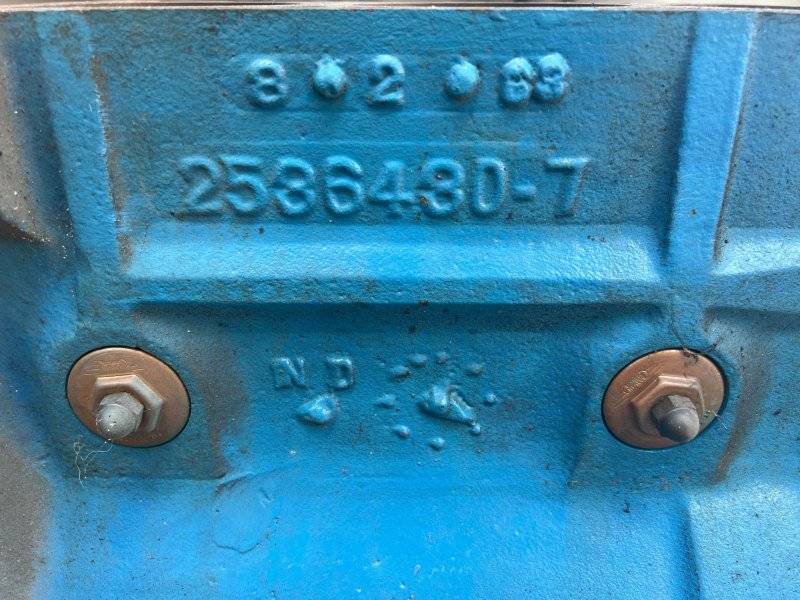

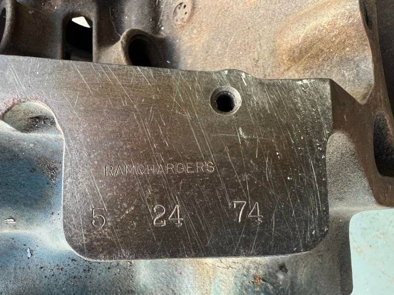

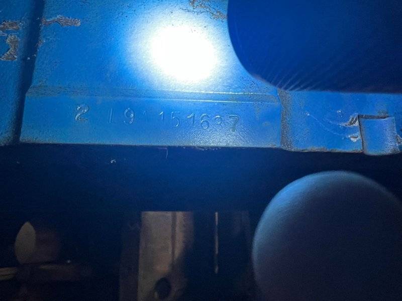

I bought this block apart of a deal a few months ago from a gentleman who has had this block in storage for years... He purchased it from a shop in Tampa, FL I believe back in the mid 80's. Other than that it is unknown on the exact history of it, but I'm assuming it is a 440 block due to the raised ID pad... The cool part is that RAMCHARGERS/5-24-74 is stamped on the ID pad. Casting number is 2586480-7. VIN location has 2 L9A 151637 stamped in it. Bore measures out at 4.340 like a stock 400 or what a .020 over 440 would be... Only information I could find with a quick google search is on stockmopar.com (Screenshot below) that shows all ???'s and to contact them if you have any information.

With the casting 8-2-68 date and VIN it was a production engine in a 69 model year car. That casting number should be 2536430. Looking at the casting numbers the 8 at a first glance looks like an 8 but I believe a closer look it was intended to be a 3. Ramchargers was stamped in there most likely by the shop that built it. Or it could of been personal property of the Ramchargers race team.

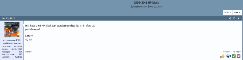

That helps a ton, thank you. Did some searching with that casting number and found a similar situation with someone else who found one of these "special stamped ID pads" as his had "LANDY/40 HP" stamped, possibly a reference to Dick Landy?

Ramchargers was also once the name of a speed parts business. Dick Landy also had a speed parts/machine shop business. perhaps your block was sold to a customer after being stamped by the Ramchargers business?

Isn't this a partial VIN- L9A 151637 ?
So, the complete VIN can only be a few possibilities
XS29
WS23
WS27
RS23
RS27
Possibly BS29
Right?
I forgot C body VINs.
