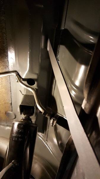

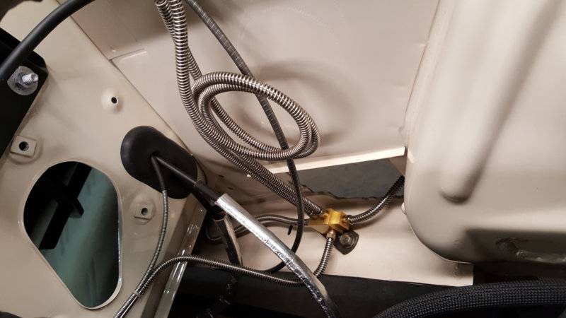

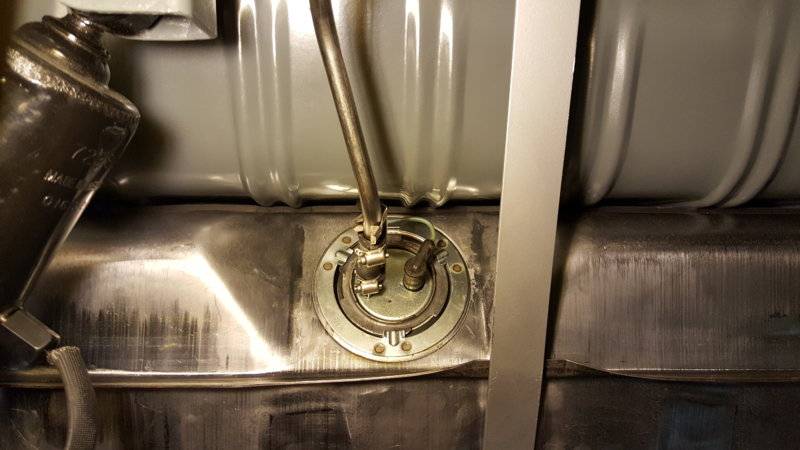

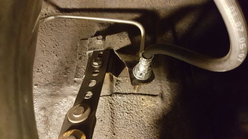

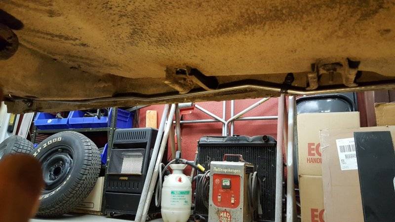

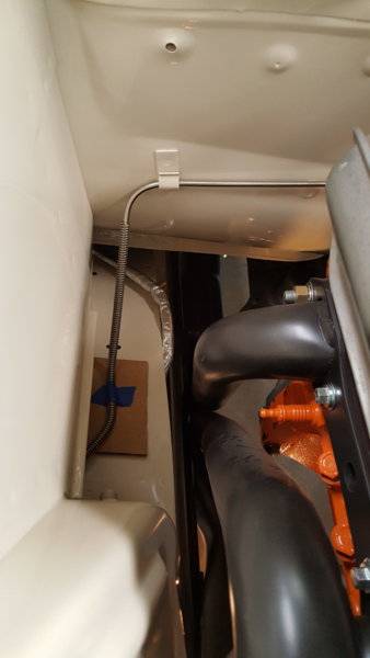

I have a 62 fury the brake lines were off when i started and i am trying to re run them. Can anyone post some pictures from the rubber rear end line to where it ties into the hard line also the path of travel moving toward the front. I think i am missing a bracket where the rubber line connects to the hard line.

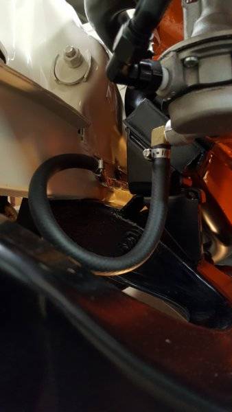

Your showing fuel lines, kid. He's asking about brake lines.

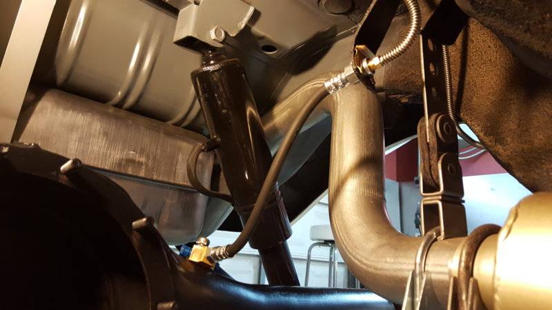

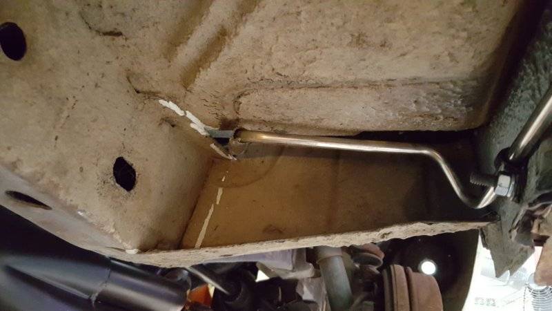

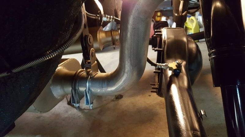

Yes, there's a simple bracket, that bolts to the underside, around where the driver's side tail pipe hanger is located. Where the tubing fastens to the hose. Brake lines go kinda like the fuel lines, but on the driver side of the car.
Holy Cow! (I'm making an optometrist appt.!)
Make sure your rear axle housing is at it lowest point of travel when installing the rubber line from the bracket to the block. The line I got was a tad short and I had to tweek the bracket some so there wasn't too much tension on the hose.
