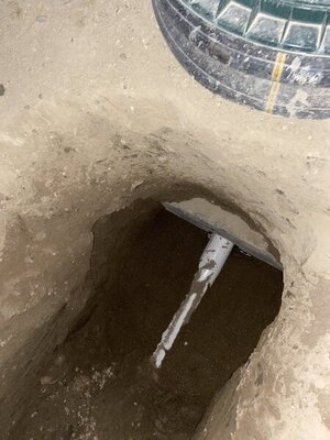

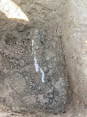

New house, I mean we bought it while it was being built. It’s 1 year and 1 month old. Early this week I noticed dirt just past the riser on the outlet side was wet looking, like someone poured some water there. So I didn’t think much about it, then we got rain yesterday. All the other dirt is dry now except this 2ftx2ft area.
Grabbed the shovel and started digging. Found the outlet pipe, dug up to the septic tank. I dug 3 feet wide by 5 feet long and about 3.5 feet deep. The dirt started stinking as I got closer to the tank, and digging became harder as it was like scooping up sticky pancake batter.
I thought the pipe was cracked, after hosing it off clean, no cracks to be found…..but as I was checking for crack(s), liquid starts coming out wher the pipe goes into the tank.

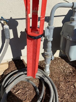

Pop off the riser cover, pull filter, it’s a tad bit nasty, hose it off, put it back inside and used the hose to have water hit the seal. Sure as ****, water coming out along the pipe. So the seal is not sealing. Ughhhh! The dirt getting closer to the tank started falling into the hole I was digging, so this has been leaking, probably since day 1!
I don’t want to drain the liquid and cut the pipe to install a new seal. So I’m asking…..what could I use on the outside of the tank to seal up against the pvc pipe?

The hole in the tank is about 5 inches diameter and looks coned as it goes inward to the tank. I’m leaning towards the roofing tar from Henry and mesh screen as it still remains pliable when dry.

the leak was likely caused because the outlet pipe was not bedded properly and sunk after install putting pressure on tank seal! when your burying the pipe I would either use A gravel [mix of stone/sand} or 3/4" clear stone packed under the pipe to support it!
Do it right!!! You only have to drain the tank some....not all. Then mortar the space with hydraulic cement.... let it set up for a few hours, then tar the snot out of the whole area.... dont try to fill voids with tar, it wont hold
I agree with Lefty 71 ,, right up to the point of using the tar, to me that is a no no , sounds to me that the leak is directly on the bottom side of the outlet pipe, and if you dig it out with room to spare on the underside the hydraulic cement will work just fine with a small bit of time for the cement to cure. The tar will only create a very messy job should you ever have to go there again. We do this many times,, only on the inl;et of the tank,, but still the same difference. A plumbers info.
