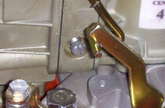

Car is sounding fine but still needs adjustment. So silly question are... what are those screws in the center carb for? If I close it and turn to open it will go almost 2 turns if much and that's it, and no difference whatsoever in the engine sound.

Yes. Pull the site plug one at a time, and adjust til the fuel is just dripping out. It’s been a while but, the metering block screws on the side of the center carb should be turned in til they lightly seat, and then backed out 1 1/4 turns.
Adjust the float levels with the car idling. If you don’t have a 502 cam. :D
I would adjust the outboard carbs mixture screws no more than 1/4 - 1/2 turn out from seated. Those screws that you circled are mixture screws for the center carb. It looks like you still have the caps on the screws. Take the caps off and you will see a small screw under the cap. Screw them all the way in and then out about 1 1/2 turns.

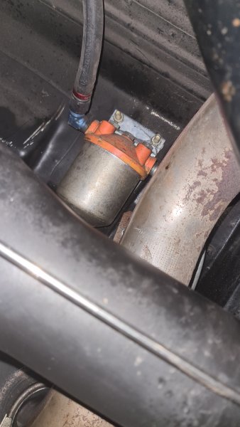

I ran an electric into the Carter mechanical on my Six Packs and had about 7-8 psi at the carb fuel line. You might want to put a gauge on to varify.
I also used the factory metal vapor separator, and ran the return line.
That looks like a hi-po Carter fuel pump it can put out 7-1/2 psi plus an electric fuel pump that could be why it's running too rich.
That set up was recommended in the DC Engine Manual. I have it on both my Charger and ‘Cuda. It doesn’t need a regulator. Like I said in a previous post, it was about 8 psi at the carbs, after the vapor separator and filter.
The electric pump is just pushing it up to the mechanical pump. I’m running the stock fuel line.
That screw in the idle mixture position of the metering block looks like a fuel bowl vent screw to me - yikes? Does it have a tapered end like this?
It might be happier at 7 psi. 2300 carbs were known for throttle shaft bind. If it needs a stronger spring to go back down, look for that problem and cure it.
My car ran too rich with the same mechanical fuel pump when I replaced it there was no more running too rich.
You could always run a regulator. My problem was fuel starvation at WOT. The electric pump cured that. I even opened up the metering plates as per the DC Manual. Yellow springs I think. This was back in the 80’s with no internet. So many guys gave up on the Six Pack because it had been tuned incorrectly. I just followed the instructions.
