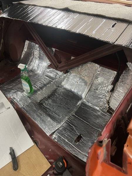

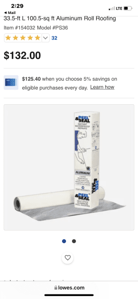

I actually used this it’s cheap and it works just like the expensive stuff.
Home Depot duct insulation here too. I like that it is a reasonable low-tack adhesive and could potentially remove it if I needed. I hung the bubble foil behind the back seat and rear tray too
As said above, all the deadeners that are foil backed butyl are the same, the only difference is thickness. When I did mine, the Noico from Amazon was the cheapest, and had great reviews. Worked a treat for me, great adhesion, etc.
Some deadeners are not butyl but are instead foil with a tar-like substance. These often get mixed reviews (bad smell and poor adhesion are the top complaints) and are not significantly cheaper. I’d personally avoid taking a chance with those.
