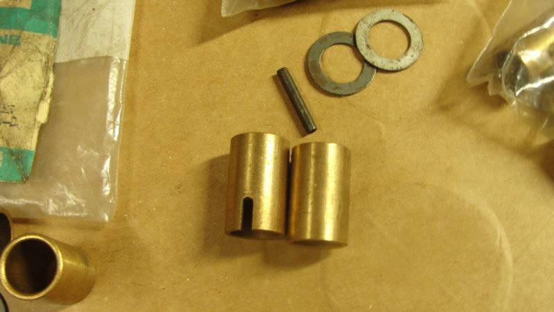

1" length, .499 ID .624 od

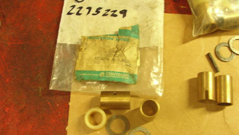

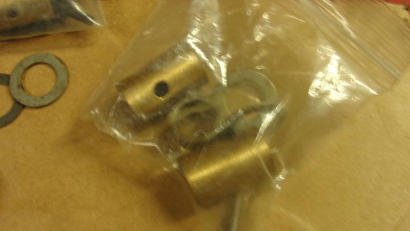

Here are three types of nos bushings. I assume they are a hair undersize so they fit tight when burnished in the housing.
The burnishing tool type I use.

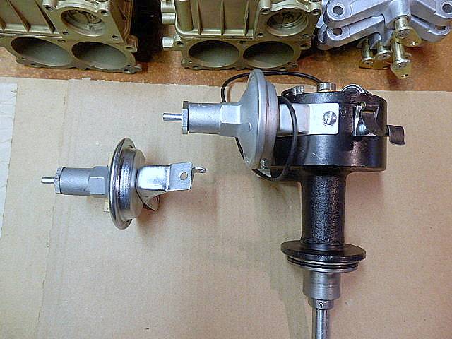

That actually looks very much like my housing and the shaft looks like a RB shaft length. Here are some pictures of this one.
Here is a picture next to an aluminum body RB distributor. Not sure if the advance plate and cam would work with it or not - might create a Frankenstein.
what do you think Halifaxhops?
Look at where the weights mount its a la if the aluminum one is a rb. The dual point weights are also different from a alum housing also just fyi. Let me see what I can find part number wise for you..
