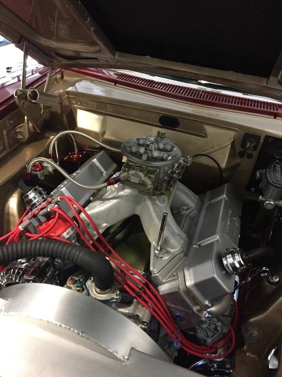

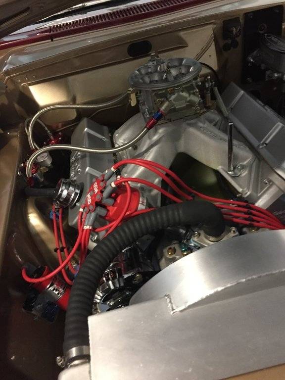

The Cometic gaskets showed up last week. Laid them on the block, checked fit at the cylinders. At approximately the 11 oclock position they come flush with the cylinder, but not hanging over. This is at the flat surface area of the head. At the chamber area the gasket is well back from the cylinders so they went in and everything went back together. A different look now without that big Indy intake and Eddies stacked on top.
The port match at the heads / intake was a dead match, didn't need to do any grinding or adding epoxy. On top of the Super Victor sits an AED 1050 Dominator with a 1/2" wood spacer under to keep the heat away. The coil was previously under the dash and now is relocated to near the distributor, which eliminated a 3' coil wire.
There was no difference in height from the Indy/Eddie set up. The carb won't be sealed to the hood this weekend. Will do something up nice along with a fibreglass hood for next season. Jets and air bleeds have been changed up to the same as what Wookie is running in his custom built AED 1050, (thanks Wooks). At mid range it seems to be over fuelling, although it starts, idles and its instant when you stab it. Wookie says not to worry, his acts exactly the same. Sure would be nice if I installed his MPH and ET along with his carb specs!

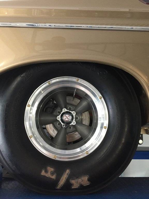

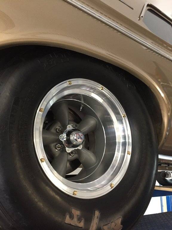

Had to drill and screw the rims as well. Last race day I marked the tires at the stem and in 2 passes the marks had moved over to the spoke, about 3". One side had moved a little more than the other.

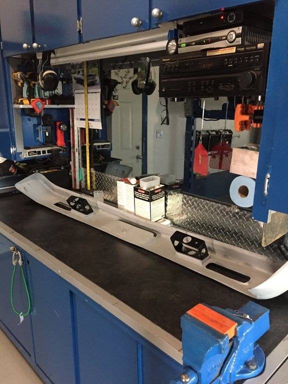

Got things all back together on the Plymouth and time to spare so decided to try and salvage the glass bumper. Have added wood along the entire top lip, studs at each end for corner braces, a centre support and additional glass in other areas that were flimsy. Also glassed in some plywood blocks with studs for bumper brackets. I made the brackets out of 2" X 1/8" flat. 8.5 lbs so far including brackets. The big job starts when I tackle the other side.. If I can make something out of it and it looks acceptable I'll try to use it.

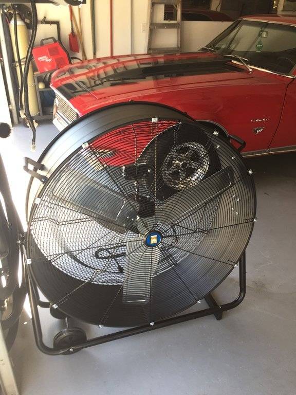

I picked this 36" 11,000 CFM fan from Princess Auto for 69 Bucks, taxes included.. They had a sidewalk sale on and gave an additional 75% off of the sale price. Crazy.. Will be perfect for those hot days at the track to cool the MW.

Too late now, but I glue my slicks to the rims. They moved about 1/2" right away and haven't moved since, at 102 passes.

No kidding.. I regret not checking with you beforehand. What type of glue is it that you use Doug?

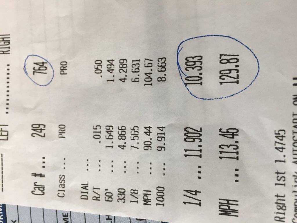

First pass. 10.39 @ 129.87mph. 1.49 60'. Got to fix that up. It might be a 130 mph day yet.

My best today was 10.39 @ 129.87. That was my first run of the day. Everything after that was slower. A very hot day with real bad air. It was a good day overall though and I ended up going 4 rounds before red lighting. What happened with that is that I rolled up to stage and the damn trans brake was dead again. I had to foot brake it and cut a -.018. What pissed me off worst of all is that my trans brake toggle got shut off and I never noticed it, will be taking steps to make sure that doesn't happen again.

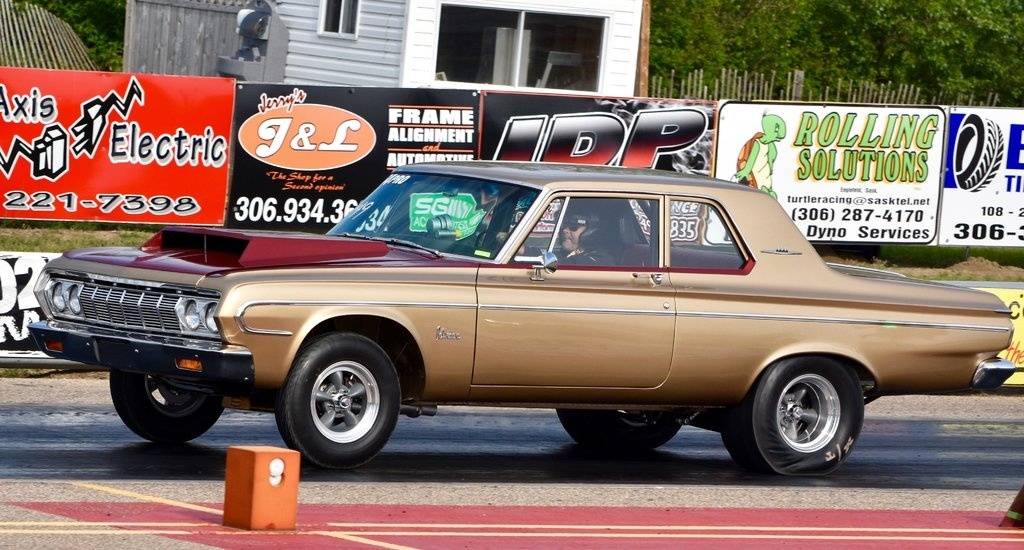

Day 2 at the track. Very windy day ugly side wind gusts. New personal time best though of 10.38 but @ 128mph.
Three test passes done and will be going into first round without a hood. The inner structure at the latch has broke last pass and the hood got up lots. So 68 lbs off, what to dial going into the first round Hopefully my first opponent red lights and I can run it out.

Day 2 ended up with a red light in the 1st round. The car left the hardest ever, amazing the difference without that heavy hood. Very happy with the progress made all year, consistently improving. As the day went the wind got worse and my 3 test passes got better. 10.45, 10.41 and 10.38. At this point it is very apparent that the Victor Intake with the 1050 is faster than the Indy/Eddies on my 505.
