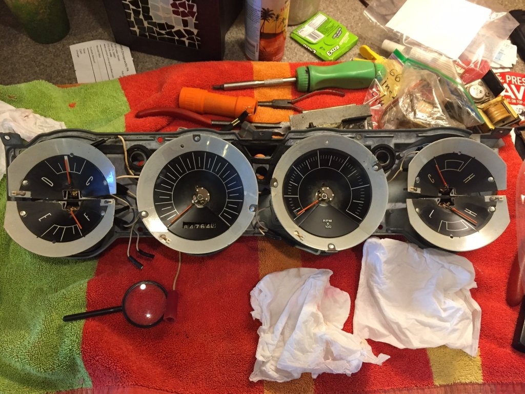

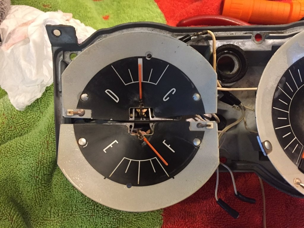

Gauges are not in bad condition just a bit dull, any tips to clean them up without replacing the prints? I want to do as much as possible before I put them back in.

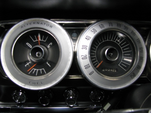

I did a few instrumentations restoration on gauges, and my way is use light polishing compound dont't worry the coating on gauges are very hard...
they look superb

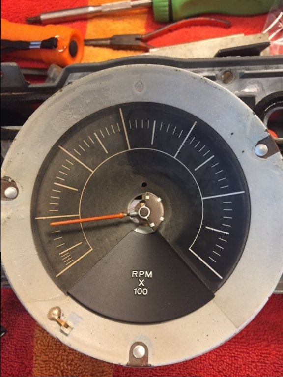

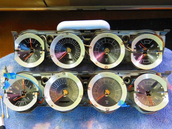

Here's the cure for old, faded Charger gauges. First step is to pull the instruments and take the cluster apart. I usually pull out each gauge as I work on it too. A digital camera comes in real handy for reassembly help. Take pictures of how washers and wires go beforehand if you don't want to try to memorize how it went together.
I use moderate red rubbing compound on the gauge faces and then coat them with Vinylex (from Lexol) after polishing. I've restored some that are almost completely white this way. The black is really thick on the face and you wont rub through unless you go crazy. Be gentle. Wipe the area you're polishing clean periodically to check progress. Use a Q tip when you're working near the pointer, there's a very fine wire there that you don't want to even touch. Be very careful here. Tip the instrument up vertical while you're working to keep old compound from falling into the gauge. You can gently move the needle over to polish under it. Be careful of the wire! There is a small hairlike wire at the base of each needle that makes them glow with the electroluminescent sytem.
These needles can also be repainted if they are dull. Use a Q-tip with some Brakleen on it to strip the old paint. (careful to not drip on the face). Soak another Q-tip with some flourescent orange paint to the point of almost dripping and coat the needle. Don't get it too thick or the needle won't glow. If so, just strip and do-over.
When done with the needle and the compound, patch any chips in the black with a Sharpie and top off with the Vinylex. Put it on thick and let it soak for a day before wiping it down. If you wipe it down too soon, it'll soak in and look dull a week later.

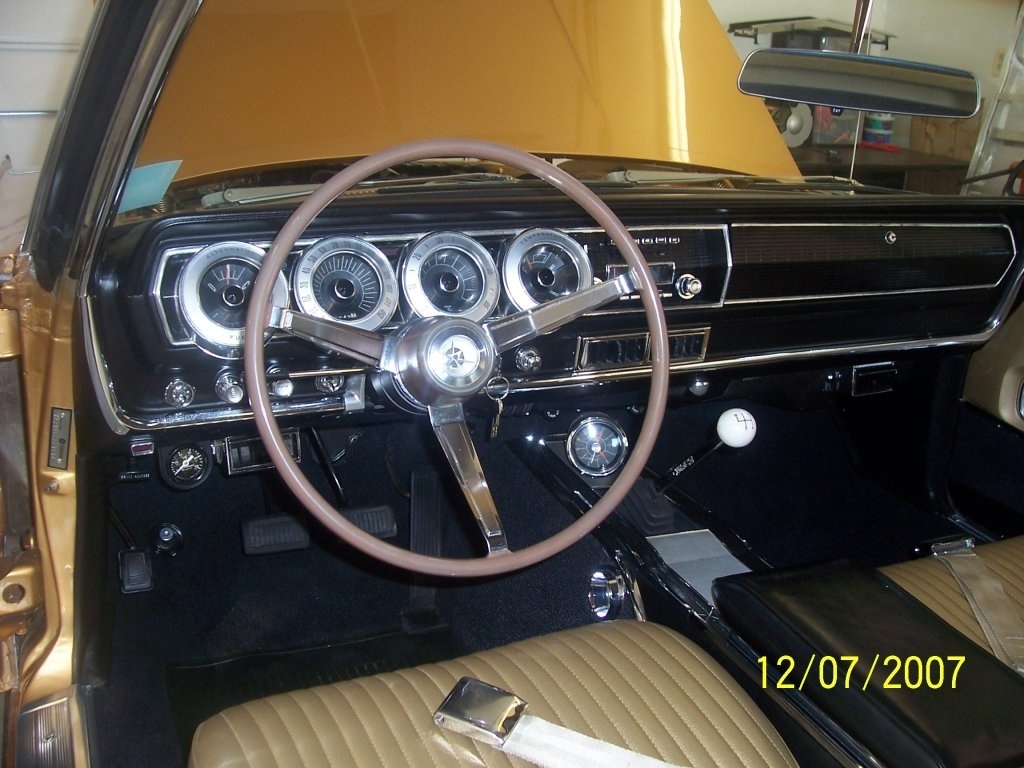

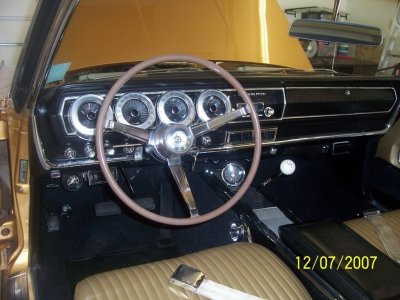

what a cool dash and interior , love it
is urs a 67 ? wish I could see the radio knobs and I have been thinking about going with that style of steering wheel since originals are fetching way too much money

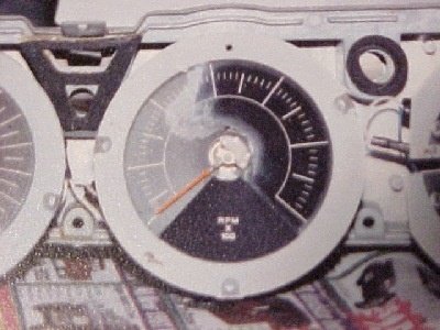

Yeah, if they have becone whitened from the sun very LIGHT polishing will bring them back.
I used a very fine polishing compound on mine ... but again LIGHTLY. The black will come off if you go too heavy with it.

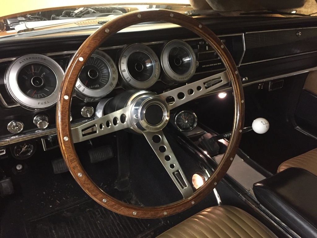

Does this older photo help? if not I will get you a better photo of the radio knobs

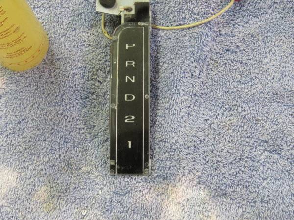

Believe it or not -- the degreaser Purple Power that you can buy at any auto store takes that white haze right off -- I'm not kidding. Use a cotton ball. Gauges go back to dark black. Easy peasy.
I forgot to mention -- the Purple Power works wonders on the shift selector and the clock face. It make the black backgrounds look new again.
