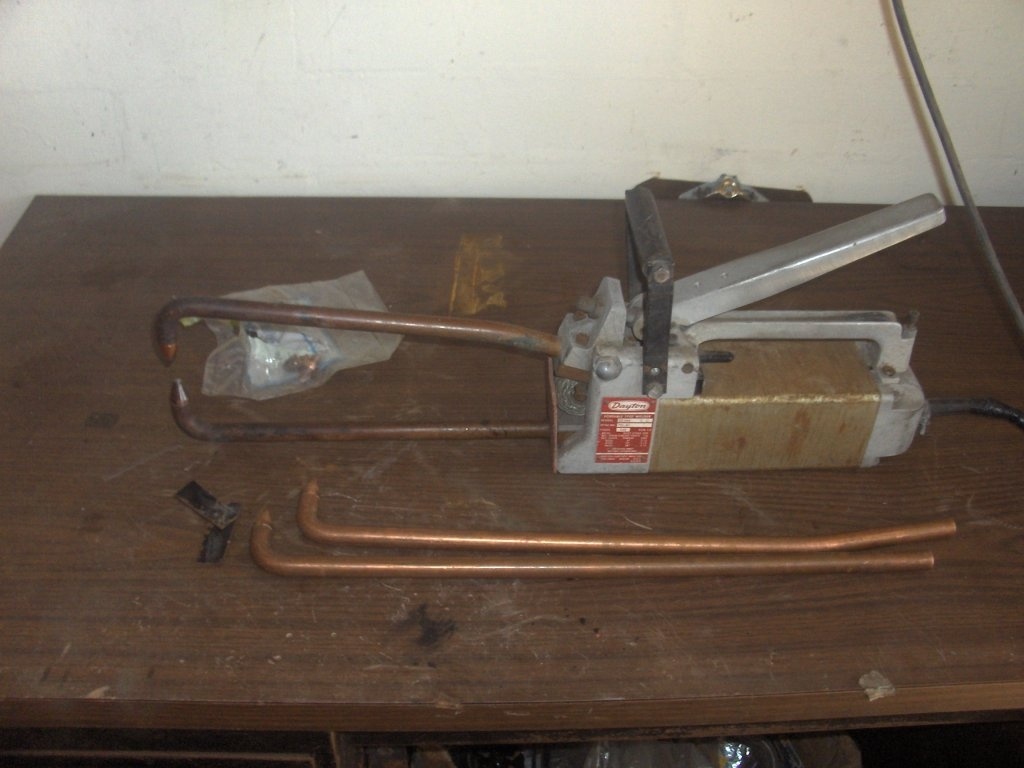

I bought this used Dayton about a month ago for 200.00 . I'd go with Miller or Dayton
