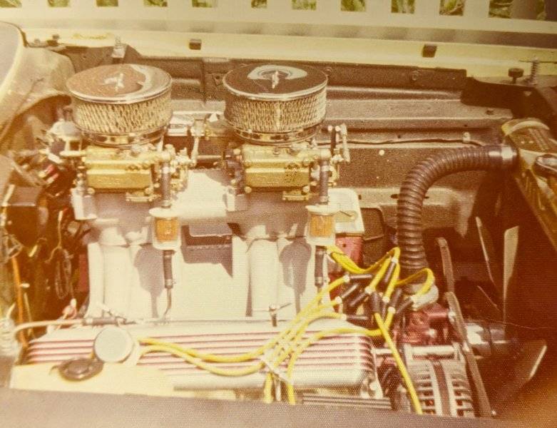

The choice is limited to three tunnel rams for the big block mopar - and virtually any carbs (other than dominators) will fit any of them. There are at least two linkages available - and both can utilize stock throttle cables - not so sure what you do with the auto linkage, my experience was with a standard trans. Photo circa 1974 or 75

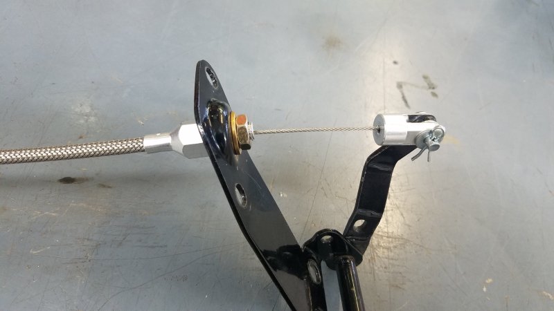

Simple linkage if you need to mount them sideways. No need for a beel crank and all tha extra linkage to fit a stock style cable. The aftermarket cable (they're available everywhere) takes slight mods to the pedal end. use a better ball stud than the supplied part. Other that that it been on the car 3 years now. https://www.ebay.com/itm/203948465886?chn=ps&_trkparms=ispr=1&amdata=enc:10utBe_E6TWyvYMj3lo7nNQ71&norover=1&mkevt=1&mkrid=711-117182-37290-0&mkcid=2&mkscid=101&itemid
The kit you posted the link for comes with the bellcrank. And that comes in handy with the added height of the tunnel ram. However, if I remember correctly the bellcrank "out of the box" mounts at the wrong angle for a BB Mopar and will need a bit of massaging.
With the longer cable there is no need for the bell crank or it's associated linkage. This setup is way simpler. These aftermarket cables are plenty long enough for any intake. I probably cut 8" off from it.
Doug
I'm not seeing "way simpler"
Where is your throttle return spring? Using the bellcrank it will be in the stock location using the stock bracket.
To use the cable you suggest he will have to fab the cable bracket. If using the bellcrank the stock cable bracket can be used.
Its obvious why you're not using the bellcrank - you can't! But it's a simple system on a standard tunnel ram that's been in use for over 50 years - and works - and is included in the kit.
