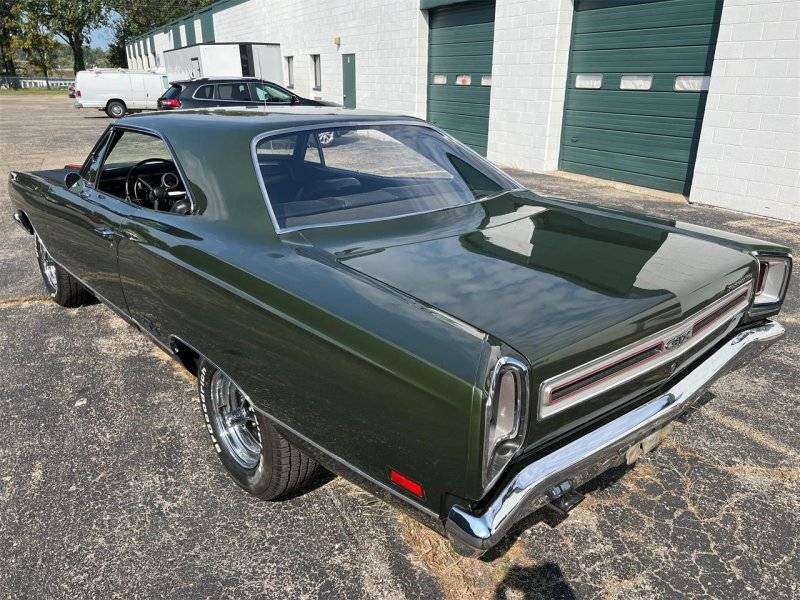

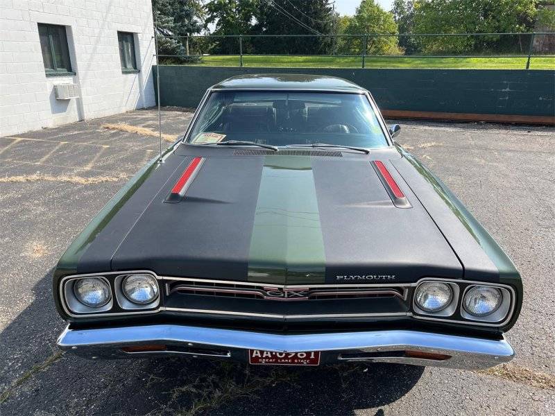

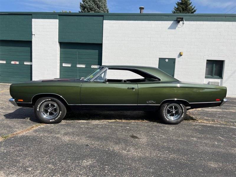

Just a few things to fix, wipers, heater, horn...but this 69 super track pak is in great shape

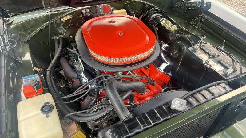

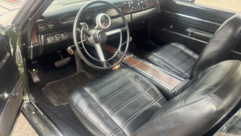

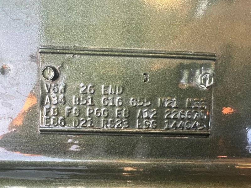

It has a period correct engine, unknown as to what happened with the original, the 833 has been replaced by a 727, not the original hood, Edelbrock 1407 and headers
This garaged Michigan car is now in Arizona, I have the 1407 altitude (4500ft) and electric choke kit (along with a new Holley 300-14 single plane intake, not installed), vintage a/c is a top priority, given 4.10 gears long driving distances and Interstate 75mph speed limits (plus flow of traffic speeds), hoping to get back to a manual trans for the Super Track Pak, with a (Tremec 6speed). I'll need to check out the bottom end if there's a decision to go with Trickflow 240 heads.
Future plans are flexible, as is my health. :) FWIW, the Mrs and I go back to the 60s muscle car era, it was a culture in and of itself, we have many wonderful memories. She (tiny) drove a 68 Charger R/T with a 440/833, I drove a 69 hemi rr with an 833 and 4.10 gears, both of us had F8 green and same color vinyl tops...this tiny little gal was/is competitive, and she burned up more rubber than I did...we both enjoy watching Nick's Garage on you tube. :)
Question, how many 69 GTX Super Track Paks were built? Also, I'm very curious about the A12? When and where was it built? The fender tag matches the VIN, but I haven't checked the right side trunk number, if memory serves me well; it is also flexible at times.
A12= Oct 12 ? Not positive on the newer fangled fender tags.
Yes scheduled production date 10-12-1968
Was built in St Louis, MO

Your build date, October 12, 1968 (A-12) could lead the less knowledgeable to think your car should be a Six Barrel RoadRunner. Nice car with attractive colour combo. When these cars were new, I never liked the green, but it has grown on me over the years.

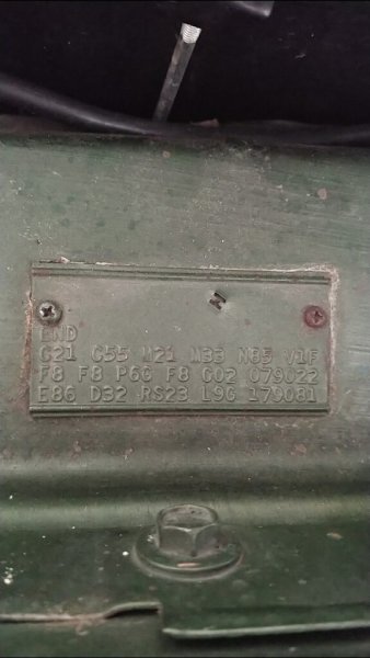

Nice. My F8 440 GTX has 18 spline A833. Dana 3.54:1. And mine not even close to number matching. In fact the split bench seat I'm pretty sure was not available to GTX? But VIN, Tag and title says RS23. So I lovingly call it my '69 GTXish. (Just to Mopar crowd.) Lol.
Would love to have your grabber hood and air cleaner assembly.

Very nice. Yes, the Air Grabber hoods add character and functional good looks. :)

Do you know when it was restored? The trunk and rear window areas look excellent.

The Mrs likes your video too, we both like the exhaust sound and seat colors.
Thank you. The camel tan I wasn't sure about when buying the car. But once I looked at it in person? It works with the F8 green. But I'm not sure it would work if colors were flipped? (Interior green with that tan body color.)
We didn't see many metallic painted cars back in the 60s, I didn't think about green one way or another, but seeing the F8 paint for the first time, all those decades ago, won me over. It was love at first sight seeing the F8 hemi rr and 0-60 on the test drive was music to the ears and a push on the butt. :)
There was a lot of buzz on the new Boss 429 Mustangs back then, with their hemispherical head design. The previous owner of the hemi rr traded it in for the Boss 429 4spd, and he later admitted the 426 Hemi was a better engine and faster on the street.
Before buying this GTX, I researched the A12 and learned no 69 GTXs were built with the A12 engine/suspension package. One of the first upgrades after purchasing the GTX was the Holley 300-14, a reminder of the old Weiand intake of decades ago, with current headers and ignition upgrades, it leaves only the factory heads as a choke point.
But it is what it is.
Agree, can't go there with green interior and tan body color, bad, bad mental imagery. :D
I know that mind image. Just wrong. Lol.
