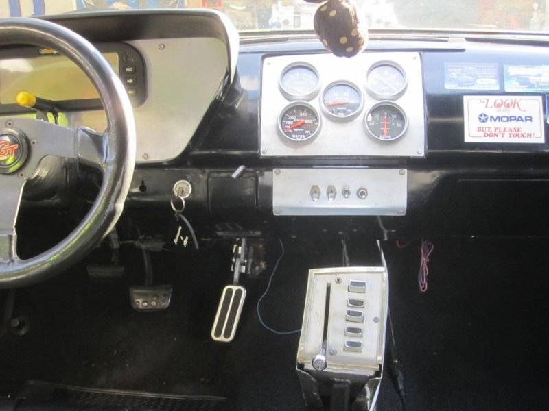

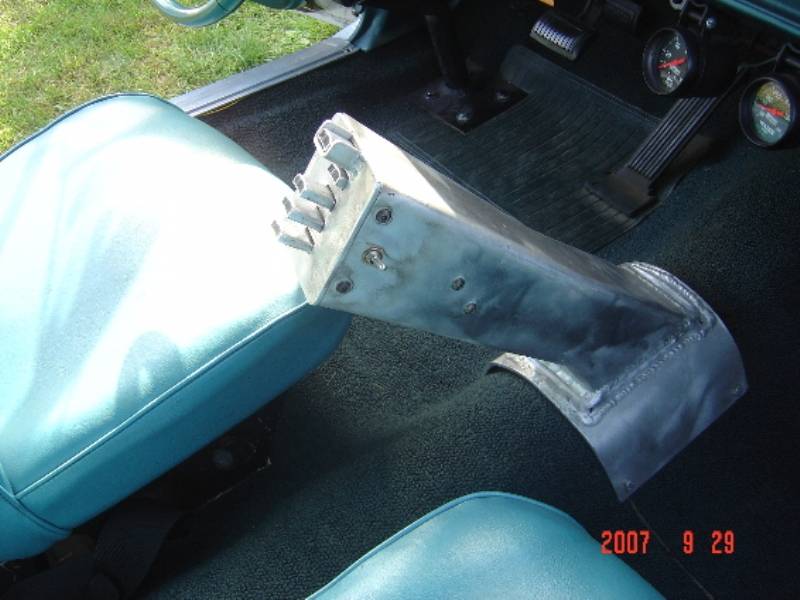

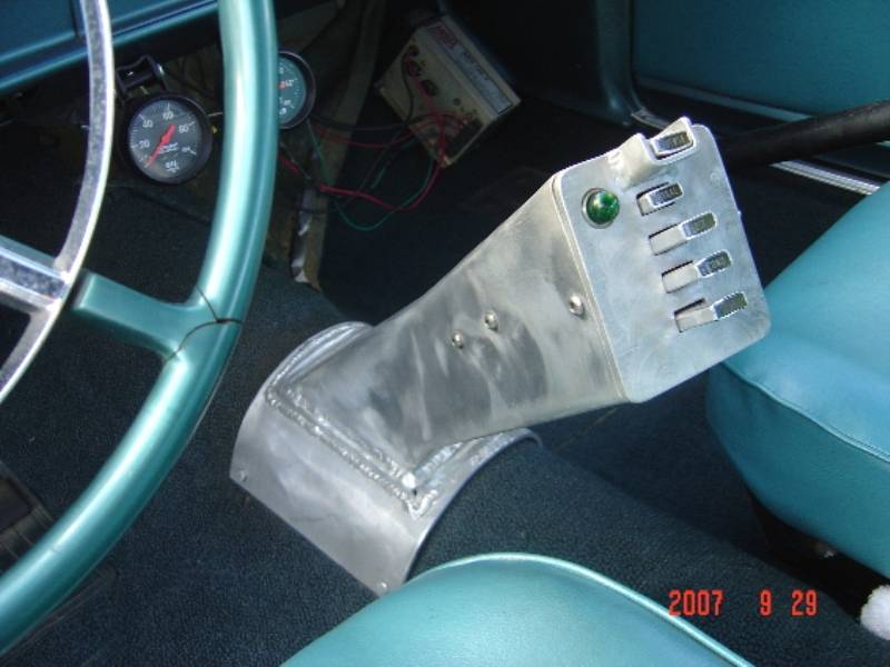

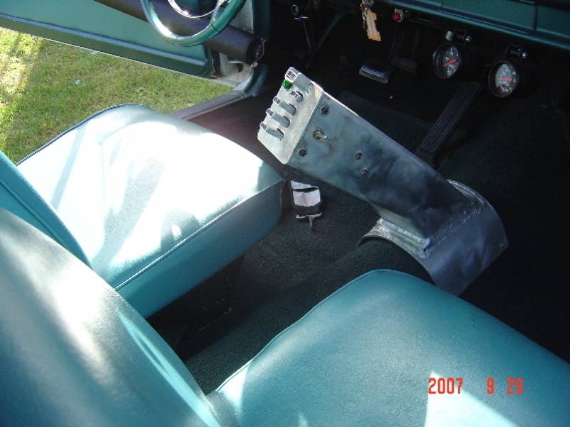

Pushing my OWN buttons for over 25 years in my streeter beater:rofl:
