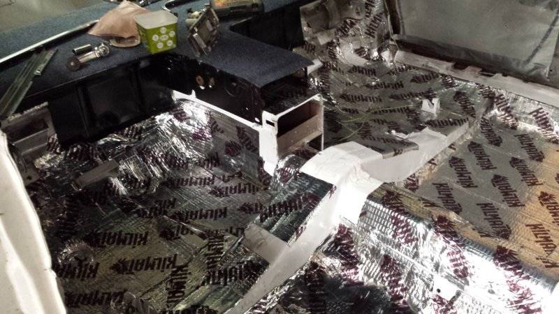

Check out Kilmat
It MAY be the most cost effective butly product.
I found and used it after much research of comparable products.
It's to cancel the cymbal effect.
So far, so good.
Available on Amazon.

It is VERY light weight and thin as is the Kilmat.
I avoided felts and things that would hold mold, dust and moisture in the pans.
