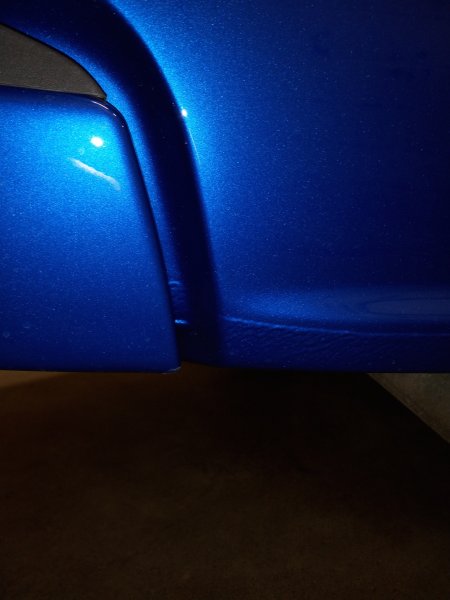

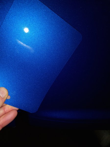

Unless it's truly a translucent color like yellow, you can and should always achieve black and white coverage. Anything else and you simply don't have full coverage .
Pictures of spray out card with black line threw it. As well as bumper primed in black and side in grey. All same color......
I always use the card.........the card is what was pissing me off with the orange and yellow :mad:
I am not a pearl fan and I don't know why it's added to paint that is supposed to duplicate the 60's and 70's colors. It turns to mud unless you are looking straight at it in sunlight.
It does matter on the color. But I know what you mean . Some colors are actually designed like that on purpose to help accent body lines and curves. Others have a crazy flop that allow the metallic to really pop from a side angle

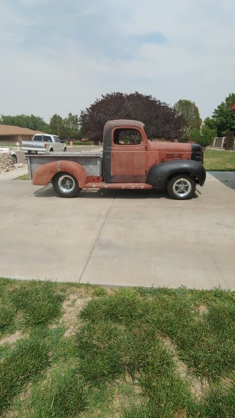

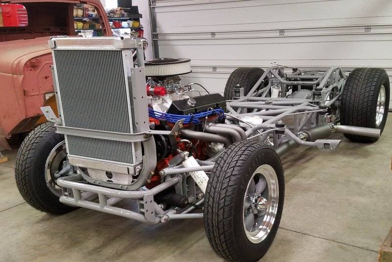

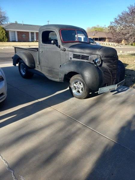

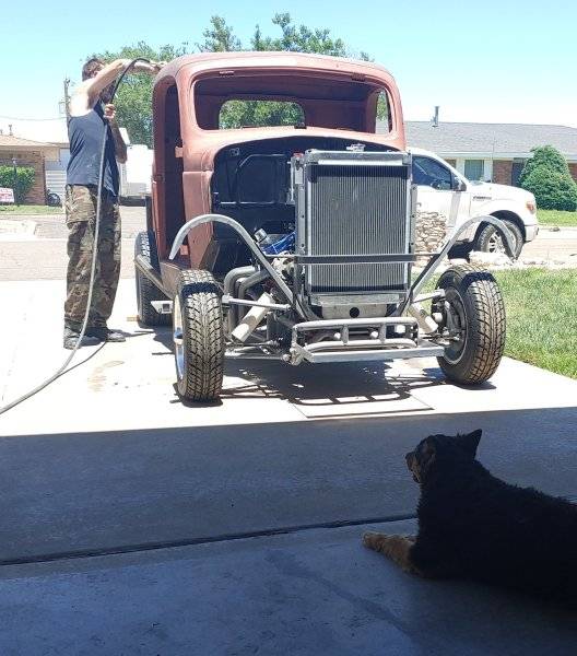

I still get crowds around this
ol' gal. The majority want to
know the year and make.
It's taken a long time to get
it to this point with
everything in this build being
custom. It turns out, the
single most expensive step
is going to be the paint,
which I'm terrible at
applying, and don't have the
money, time, and energy to
complete. I'll leave it up to
my son if he wants to see it
thru.

Is he hiding his face from the camera, or crying because he got a splinter in his eye?
