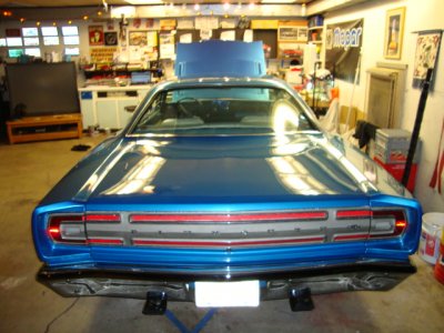

this is the current tail panel, hence the resto!!

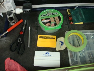

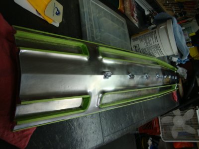

so far i used the green 3M tape for the straight edges and for the corners i used "frog tape"; its on the same order as the 3M, but a bit more workable.

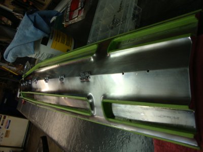

the light green is the 3M and the darker green is the frog tape. this part has been the biggest PITA so far; trying to get the right line cuz da chrome is so damn shiny, you cant tell what is what!! lol
i didnt tape the letters and scuffed around them free hand...just got be careful, it's pretty easy if you watch what you're doing. (obviously i will be taping them for primer and paint)
i have scuffed the panel with the green 3M pads (used 4 of them btw) and then tore off the first tape job and re-taped the panel cuz those pads tore the tape up pretty well and i want a nice fresh line. (it was a helluva lot easier to tape it off this time!!! lol)
these are tools of the trade...lol
im going to sand with 80, 180 and 320 (wet) next. i may not do the 80, it may cut a bit too much, me thinks. but ill let y'all know. hopefully i wont have to tape again until i prime it, but we'll see about that!
the prep spray is what im going to use to clean the panel after sanding, and then a couple nice light coats of self-etching primer. from what Jay told me and what i have read, de-greasing is VERY important so you dont get fish eyes and the self-etching primer is also VERY important so the paint doesn't peel off of the chrome substrate.
