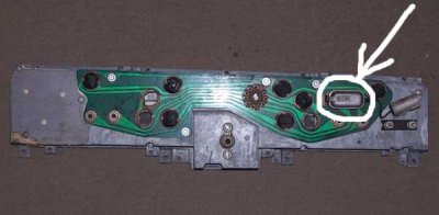

Does anyone have a picture and location of a voltage limiter?
This is a 69 cluster, the limiter is circled, it just pulls out to remove.
Or is it the same component called a voltage regulator beneath the hood on the firewall?

And as punkn8r stated a wire from a known good ground to the back of the voltage limiter on the back of the cluster.
