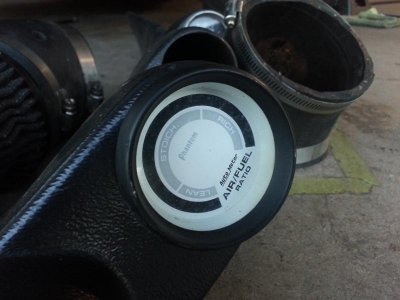

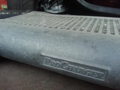

$250 bought me the head unit, pulleys, mounting bracket (for chevy), procharger intercooler (6"x18"x3" core), autometer phantom af gauge, fuel pressure gauge, bov, and all the piping. The head unit shows its age with a little surface rust on the compressor but there's no shaft play or chunks taken out of any fins or anything, and all in all looks like a pretty good unit. Worst case scenario I send it in to be rebuilt, I'm still heaps of money ahead of buying a brand new one. Can't even say how excited I was to score this deal haha

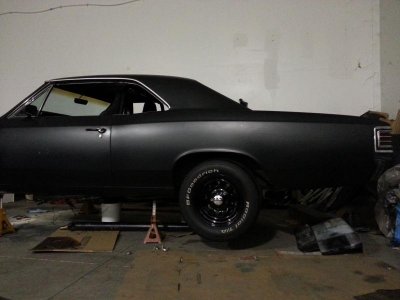

Sorry I haven't been on too much this past week, been keeping really busy throwing the Chevelle back together. Had an early Christmas when my box from Summit showed up lol

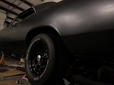

Staying with my ratty oldschool nascar/ mad max theme for the chebbie, also ordered a set of Cragar D-windows. Got the tires mounted and test fit the rears, should be pretty mean once it's back on the ground tucking a little tire.

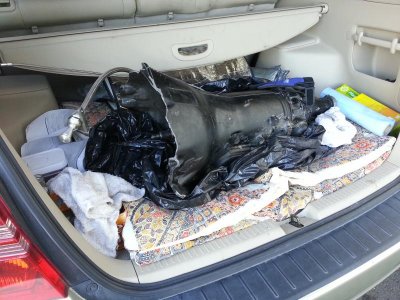

Finally got another ball rolling that I've been waiting on selling the truck for, and took my 700r4 up to my transmission builder friend to have the guts frankenstein'd into a new case. The crash must have buckled the engine and trans, and grenaded the upper bellhousing holes. Luckily the converter looks like it escaped ok (trans was still bolted to engine after the crash by the lower bolts). Gonna be good to have that back and get the whole drivetrain back on the rolling chassis

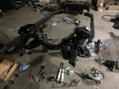

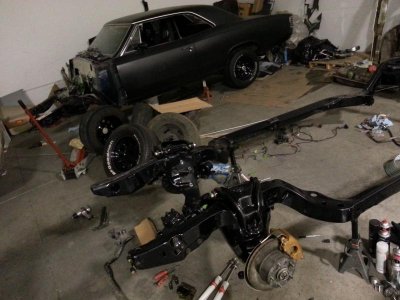

Spent a lot of time last weekend shooting a bunch of front end parts with that jet black chassis saver, steering box, motor mount pads, spindles, etc, and started bolting everything back up. Hit a roadblock with some screwed up balljoint stud threads, must have tagged them with the hammer when I was separating the spindle. Hopefully have that taken care of and all buttoned up tonight.

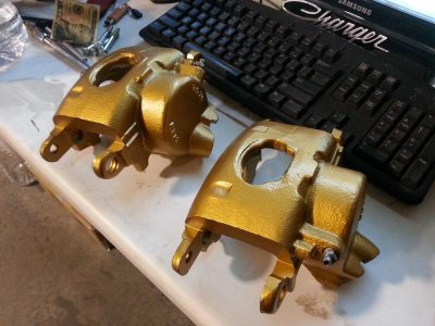

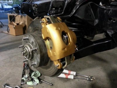

Also decided on kindof an oldschool (I think?) color scheme with my calipers (4 wheel disk): gold metallic (VHT high temp engine metallic) behind those black cragars/ flat black body. Think it'll be a little unique and a cool subtle highlight against all the black.

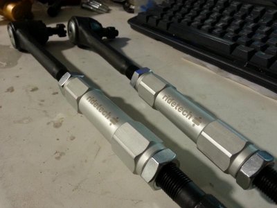

And speaking of brakes, I hit another roadblock on the Charger when my front hose fittings weren't even close to fitting the calipers. Did a little research and it turns out the calipers' application is listed as early 70's A-body, Imperial, and '74 only Charger, so they're supposed to be a banjo-type fitting. Luckily Inline Tube sells a stainless braid version of them so I'm about to get em ordered and give the Charger some stopping power. The paint came out pretty awesome on those calipers too though haha

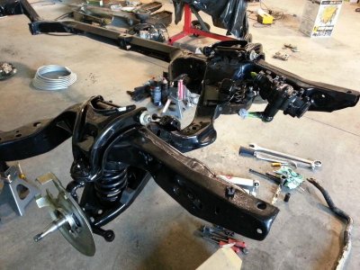

Punched through that little roadblock and had some more victory yesterday, the interceptor's front end is finally back together haha. I had to undo, adjust, and re-tighten the spring compressors more times than I care to count (damn chebbies and their coilsprings), but feels pretty good to have one more mile marker in the rear-view
Now I just have the gravy stuff left, bolting up shocks, steering, and the monster 1 1/4" swaybar. Had to laugh at the nice billet sleeves on my chinesium tie rods though haha
