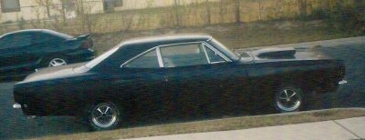

This is the last picture of it in running condition. lol. I think it was taken in 2003.

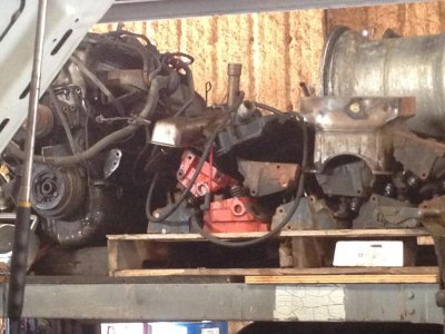

So this is the pic I took after the engine builder informed me he had the heads off the 440 that got auctioned off (they are the orange ones). It is still kinda crazy lol.

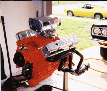

here is a pic of the 440 I use to have when I did the rebuild on it..
