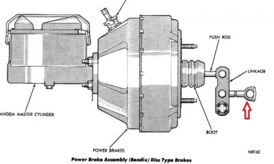

I converted my 1970 Road Runner from manual drum brakes to power front disk. While everything hooked up per the FSM, my brake pedal height is too low. It doesn't even contact the brake pedal switch so the brake lights are constantly on.
Does anyone know if there were different sizes for the Bendix linkage, especially the rod (shown with the red arrow below)? It seems if I make this longer that it will fix my problem, but I don't want to start hacking into the brake system until I understand the issue.

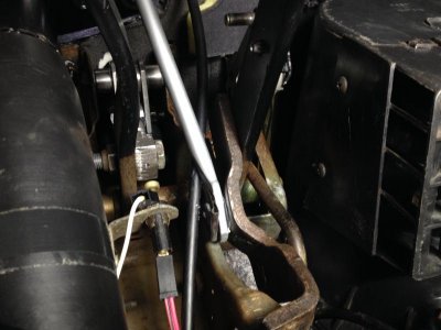

Here is the overall problem with the brake pedal.
This picture is upside down, but this shows how the brake rod doesn't even contact the brake pedal switch.

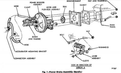

Here is my Bendix style booster. It almost seems that the rod shown with the red arrow is too short? Or could it be the push rod from the booster? Or maybe were there different mounting holes in the brake pedals? :icon_scratch:
Here is another picture from the FSM on the mounting of this booster. Mine seems to be mounted exactly like this.

To replace the push rod on the master cylinder? And I am fine with doing that, I guess what baffles me is that to the best of my knowledge, I have used all stock parts. I could see if I was adapting an aftermarket brake system, but if these parts are all stock brake parts, why the &%$#! doesn't it fit?

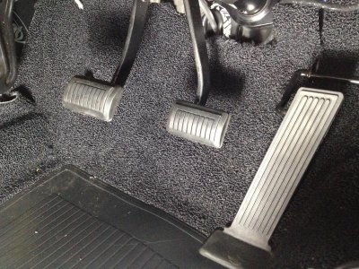

I cannot measure my car right now, but I can say that my brake pedal is low. The clutch pedals are always high...and it does look odd when both are at rest. The brake light switch can be adjusted if that helps at all. :icon_thumright:

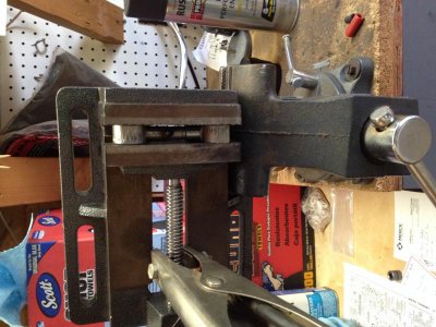

Thanks guys for all the replies. I decided to lengthen the brake rod (the one in my earlier post with the red arrow).

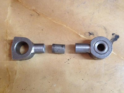

Here's what I did. I first cut the old one in half, and then I cut a bolt to the size that would make the overall rod the right length.

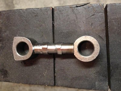

Damn picture got rotated again... When I was ready to assemble it, I put it in a vise to hold the ends in the same plane, and then I tack welded the two seams. I then fully welded the piece outside of the jig.
Here is the finished piece after I welded and then ground down some of the weld. I elected to leave some of the raised weld on there to give it extra strength just in case my weld didn't penetrate so good (I am pretty sure it did). No one will see it anyway, and it won't get in the way, so why not leave it?

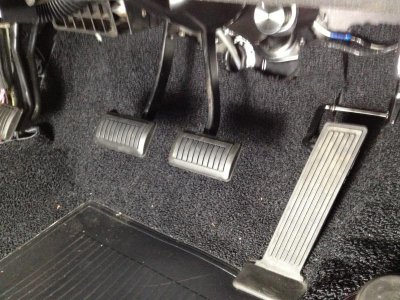

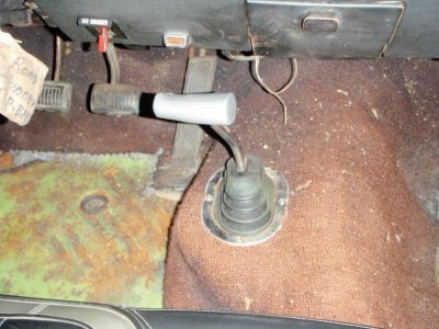

Here is the finished pedal assembly. The brake pedal is just a tiny bit lower than the clutch, but is at a height that seems closer to where it was originally
Here is a reference picture of my original setup. They are pretty close now, so we will try this out and see how it works...
