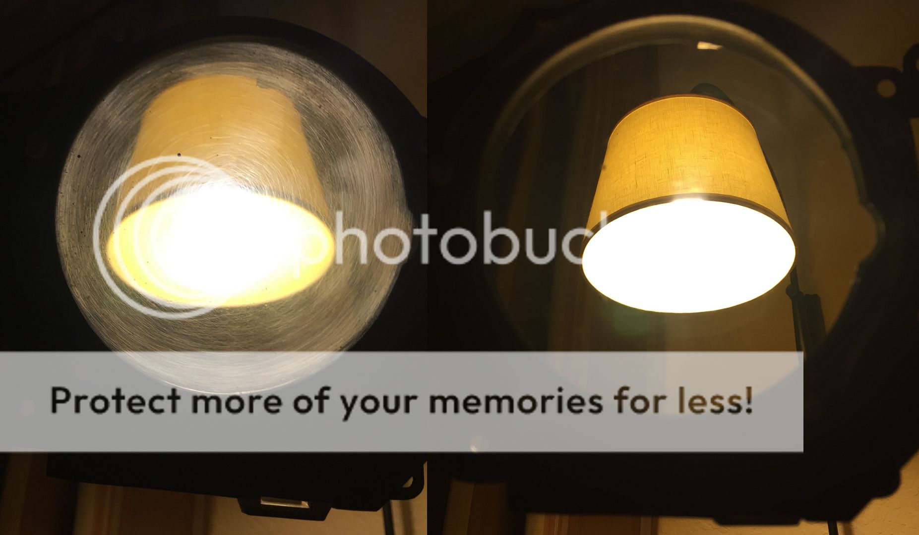

Then it was might as well pull the instrument panel, since I cant stand the ugly wood grain and been thinking about painting it gray. I know Im in good company about the fake grain. Even John Herlitz hated it. For those of you wincing about me messing up a perfectly good roadrunner, I hear you, but my car had a blue interior, and now its black. Frankly, I like the black, and I dont want to start changing it back, so loss of the original color on the panel is no big deal. Anyways, now I have everything out and started cleaning and polishing things up. I dodnt realize how messed up the instrument lenses were until I looked at them at a light. Before and after below after about 5 minutes polishing with plastic headlight polish with a buffing wheel on a drill.
Yeah, Im exciting on a saturday night with the wife out of town:
