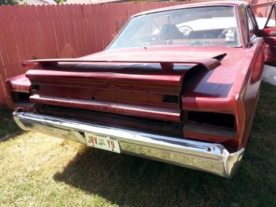

So it begins!! I put the R/T in the backyard last night so I can start disassembly and repairs. I'm not going for a total restoration, but just want to repair some of the rust issues that I have found. Replace some of the rubber seals around the doors and trunk. And get ready for paint and new carpet. I hope the rest of the floor is in better shape.
I can't decide if I will put the wing back on. Not sure if I want to put holes in the lid it took me so long to find. As you can see its mounted on a 66 trunk.

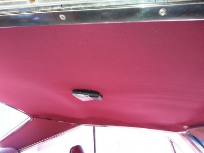

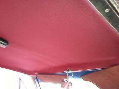

Here are some pictures of the headliner I did last month. I forgot to post them. Still working on an idea for the joint at the sail panels.

Gonna be a great car when you get it repaired and painted. Ditch the wing, just doesn't quite fit the body styling imo.

Buy the way sweet car .deff loose the wing doesn't do anything for me on that style car .
A car like that doesn't need a wing it's drop dead gorgeous without. Good luck on your welding it looks good so far from here .
