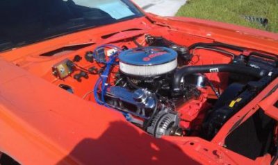

I have to say the 318 is a great engine, no real reliability short falls BUT plenty of them when it comes to performance. I personally ignore the motor unless its for a farm truck. IMO you can grab a later model 360 out of a junk yard, toss in a cam, a slug with a bit more compression, a tiny bit of port matching and call it a day, not a rocket ship but it will get you sideways with the right gears and a snappy automatic...

Soundsb good so far keep it up ,hands on is the best way to learn. If it doesn't work out keep trying you'll figure it out . Yeah let's see those picturesi ts a shame your not closer I'd set you up with a good motor (it's not fast but ready to go)good luck and keep us posted
