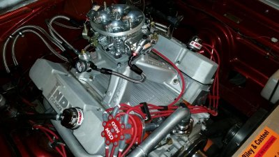

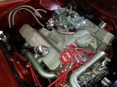

Here are 2 pixs....
1) First picture is my "new setup" Edelbrock Victor 440 with my new Holley 1050 Dominator adapted to the Victor with a 4500 to 4150 Adapter.
2) Second Picture is my "Old setup"....850 Mighty Demon on INDY Dual Plane...this is the setup I went 10.989@120.6 with little or no time to wring out timing/jetting/launch RPM and Tire Pressure.
Note: I sold the INDY Dual Plane that is in the 2nd Picture and the motor now ONLY has the Edelbrock Victor 440 Single Plane. I will mount the 850 Demon with my Wilson CNC Tapered Spacer on the Edelbrock Victor 440 Single Plane. This new single plane setup (with plenty of time to sort out Jetting, etc) hopefully will go in the 10.80's with the 850 Demon setup ...then I will take off the Demon and put on the Dominator (like in the top picture) to try out the Dominator.
