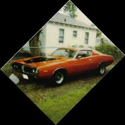

Nothing wrong with being a kid, or being wrong. That is how we learn. We generally learn from those who have been around these cars a lot longer than ourselves. I personally learn from listening to others and taking what i can from the conversations. "then in certain years as I stated as there were no couple s in 71-72" I can assure you I now own a 1972 Rallye Charger which is an original 440, 4 speed car with a Dana 60 354 geared rear end. Its a hardtop, not a coupe (post car). I do have pics of it. I personally have seen more 72 Charger hardtops than coupes (post cars). I do know here in town of one post car that is a 72. As stated i like the hardtop a bit more. My car is suppose to be one of 165, according to Galen Govier's lil white book.

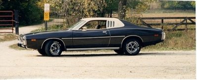

I think the confusion here is the years you are talking. In 73-74, yes the coupes (post cars) were the SE's generally, which of many were well optioned cars. I honestly can't say I remember looking at a two door hardtop for 73-74, but then again, I wasn't much interested in them. Here's a 73 Charger SE fairly optioned car. Since the body style changed after 72, its hard to say the 71-72 models are anything like the 73-74. Even the values are different. The 73-74 is generally lower in value than what a 71-72 will be worth. This also applies to saying a 68, 69, and 70 model Charger will be worth more than a 71 or 72. A 71 or 72 is worth more than a 73 or 74 model Charger (generally). We also need to keep in mind the engine variations can change value, also.
