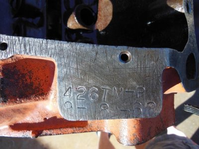

any body able to decode this max wedge i.d. stamp?1st row is easy..the 2nd is another story.
426 TM-P
and I think 8 - 8 - 62?
if it is "62",that's a lot of engines in sequential order?? on aug 8th..
have not received the block yet...only have this pic....
looks like 426, T = 1963, M-P = Maximum Performance, 8-8-62 = build date for 63 car
That's my guess
That's my guess
agree it appears to be for a very early 63 low compression car & doesn't look to be heavily decked or bored the stamping font also looks to be correct, any idea on the casting number or date?
it seems like at the early mw blocks I come across are also august cast.
im told its std bore..2406730-1 block casting...11-1 motor..wasn't sure on the stamp..everything I read says the last digits r the block assemblys for the date in 63...but 1962 august does make more sense..motors complete,picking it up this weekend..
Going by this TSB 63-1A the earliest 426 MW is 27th August.
so,,based upon that service bulletin,,,if its an 8.its fake.
or,,that 1st digit is a 9.covered in surface debris..I guess im going to find out Thursday evening when I get there to load it up..
I doubt it as they probably had some prebuilt for early production they did weird things back then, I even had a 413mw factory bored to a 426 & stamped as a correct 426mw with all the correct fixins.
does it have a 1/2" oil pick up hole, the valve notches in the cylinders look correct
yeah,, I heard that there was a lot of inconsistencie's with the max wedge line's.the internals did check out with #375 rods and 11-1 pistons..#2406646's..heads r #286's.stock rockers and stands,valve covers.crossram,,crank,misc etc,i asked the guy over the phone what size the pick up tube hole was but he didn't have anything to measure it by..
Im leaving early tomorrow morning to pick it up and will be back Friday evening...will let u know then..

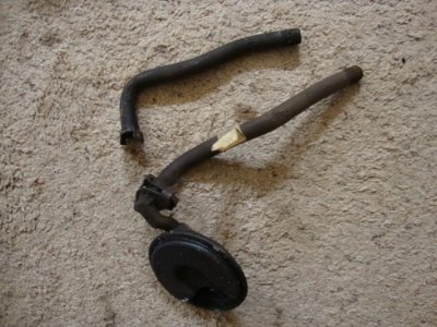

Anybody seen a pickup like this, found these pictures and was told they were a max wedge. My friend raced a max wedge back in the day and had a lot of max wedge parts, don't recall ever seeing one
like this.

its all legit..has the 1/2" oil pick up.and another inconsistent max wedge tell has popped up yet again...block has all the usual...correct i.d. stamp,notches on the cylinders,1/2" oil pick up...2406730-1 casting...BUT, by the AAQA it only has a sideways 1 and no R.....go figure... my 426 marine block..same casting number,,has the AAQA 2R..xtra thick block..just no max stamping. and 1/2 pickup and the notches...

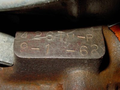

I think your build date is 8th of September 1962 (9-8-62) one week after this engine.Compare the stamping.So this would be within the correct dates.
Strange the 2R is not present.Greg Lane has a spiel about the presents of a 2R on his website.

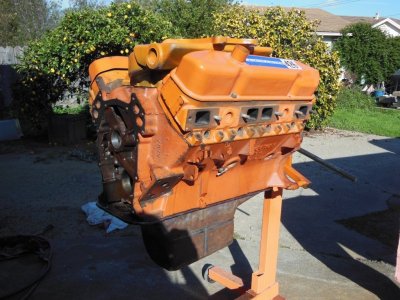

More pics of your booty Stage3
yep,,1 week after yours.brothers ?lol.i read greg lanes article also saying all were 2R's...I guess nothing is written in stone when it comes to these engines..but im not complaining.
but hey check these out,,this is what Christmas morning looks like..that deep max wedge pan I already had...if I get time today I will mock it up with a set of NOS hooker 5319 race headers and take some pics..
