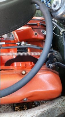

We need a picture of the part before we can answer that. I have adapted kickdown linkages from pre 65 Chryslers to work on later model 68 and newer cars. The slot on the linkage fits around the carb throttle cable hook up stud that sticks out sideways from the carb linkage. Maybe someone could post a picture of the set up. It's also possible to find a pic online.
Wow.... that linkage looks similar to a 70+ 4spd locking linkage. Garys1969RR may have some experience with this, but it doesn't look like any kick-down linkage I've ever seen. There isn't the "slot" that Gary talks about.
I'm not really in to aftermarket cable kits(?). I still all have my oem. Sorry(lol). They just don't "trip my trigger". One of these days may have to go that way. Old school-mechanical is my way.

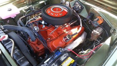

This is before I swapped to the RPM Performer.
I have a latter model linkage set up, from the seventies. Is this what you used ? I have been told it might not fit. For now, there is a small block in the car, and the 440 is on a stand.
Now is the time to set up what your going to use. I
would think you have a BB trans? That pictured setup isn't worth the trouble if it would work at all. Either find a stock setup or a cable. Put the trans and engine together before it goes in the car. Then mock it up so it works like it's in the car. Go to MyMopar website and download a service manual so you can adjust the throttle pressure control linkage(kick down linkage) right.
