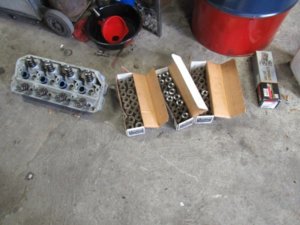

Just bought a set of unknown brand octagon shaped Ti Retainers with holes drilled around the top and Ti locks. They came as a package deal on a set of CT 1574 ML Dual (PSI) springs I bought on fleabay. Said they were only used for a dyno test and I saved about 200 bucks from what this stuff would cost new, so who knows! They will be used on a .262 @ .050 dur .645 lift roller...I also had concerns about longevity but it seems others are having good luck with them.
Anyone know what brand retainers these may be?

I was told the holes are there to get oil down in between the springs in return reducing friction between the springs and therefore reducing heat. Who knows if it actually helps.
I would still throw them in the spring pressure tester to insure the spec! Must degree the cam.make sure the valves seat right and geometry is on the money!!
