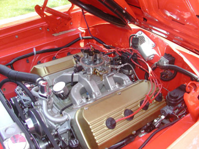

I just took this in on a trade. I really need to sell it, but I think I’ll hang on to it for awhile just to admire what’s under the hood.
