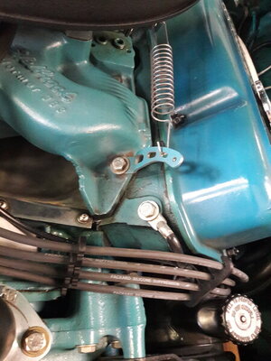

Yes, here is a picture of mine.
Nice, but incorrect. The cable end is formed the way it is specifically to fit UNDER the throttle spring bracket. NO washer under the bolt head either as RC shows above on his RR. The "serrations" you see on the bracket are not from a washer, the bracket was stamped this way..
Keep in mind the reason the cable end was mounted under the bracket prior to painting was to ensure a good ground. Hopefully you cleaned the end, underside of the bracket, and mounting surface of existing paint before mounting it.
Thanks, fixed it
Rebels pic is the most correct. Correct spring with the bracket engine color
