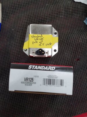

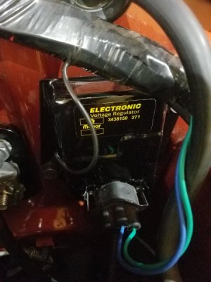

During restoration I installed a brand new USA made MP 3438150 voltage regulator. It was working great for 200 miles and then I noticed the operating voltage had dropped from 14.2 to 13.2. Had the alternator checked and it was fine. Called Summit and they sent me another Mopar regulator under warranty. While I was waiting for that, I bought a couple of Standard VR125's (made in China). I put one of those on and everything was fine again. Last summer I noticed the volt meter was running over 15, but chalked it up to cheap gauges. Finally got around to replacing them with some good Autometers. I now have 5000 miles on the car. Same high voltage as before, and this time I verified it with a multimeter. Was running at 15.5 volts. So I dug out the warranty replacement MP that Summit sent me years ago. Installed that and the voltage was right at 14.2. Life was good for a week, but now the voltage has dropped to 13. Dug out the second Standard VR125 I bought previously. This one is putting out 15.4 volts. So I have 2 Mopar 3438150's that both started out good and then went to regulating around 13 volts. 2 Standard VR125's. One ran for quite awhile ok and then over regulates at 15.5, and the second one is 15.4 out of the box. All 4 of these units were bought at the same time. Anybody else ever had a crazy situation like this? Are there better regulators I could try?

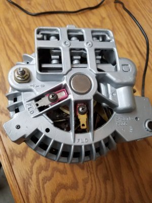

First of all, the origional alternator was a round back style, depending on origional accessories, it was either a 37 amp or 42 amp either single or dual sheave drive. Most aftermarket replacement alternators are the square back alternator design shown. Their capacity very depending what the origional unit came from. The regulator you show is correct for either styles of alternators. Internally, they have components that vary the alternators field voltage to provide a nominal 14.5 system voltage. There is an internal voltage divider network, inside the regulator, that also provides temperature compensation to allow for cold weather, allowing higher system voltage and lower voltage in hot weather. Because of the origin of these internal items, the ×/- tolerances on these components are likely causing the disparities. In addition, insure that the case is securely grounded to the engine block with its own wire. The field current is low, 5-6 amps, at maximum charge rate, a 14 AWG wire is sufficient. I'm sure others will have their own ideas and suggestions.

The harness was a new M&H when I built the car. Terminals look good but I will ohm them out tomorrow. Just remembered that a guy gave me this meter years ago. Oddly, both Mopar regs test good and both Standards test bad.

When I had the alternator rebuilt, they replaced the 37 amp internals with a 60 amp version, I don't think that has anything to do with my problems though. I do have a seperate ground wire from the mounting bolt to the battery. It is probably only a 16 gauge wire. I think I am going to redo that with a 14.
stock fields wiring is actually 18 gauge.

Sure I'd check the ground between reg and firewall. Not saying is that but worths checking that.
My brother had a ‘70 Challenger back in the 80’s that constantly drained the battery. He had it to several garage’s and even an electronics specialist. They gave up. I found it to be the ground on the voltage regulator.
As previously stated the Mopar voltage regulators need to be earthed to work properly.
Might pay to check yours - paint can get in the way.
Yeah, I have the paint scraped off where the bolt head rides. I'll stick a star washer there as well.

Learned something new today. I didn't realize that the output voltage is supposed to drop as the regulator heats up. Guess that's what Bob was referring to in an earlier post. So my 13.2 is no doubt ok after I have the car heated up. I feel better about that than the 15.5 volts put out by the Standard vr125's. It still seems weird that the Mopar ones will put out 14.2 all the time for a couple hundred miles, and then drop after being in service. I will check out that regulator you mentioned.

Have you checked for voltage drop between the battery positive post and the ignition 1 terminal (regulator reference) at the regulator while under running load? Any resistance at any connection in between will cause a higher-than-normal charge voltage measured at the battery. Beginning in 1970, column mounted ignition switch, the Molex connection at the bottom of the column has been a problem since very early on. Bulkhead connections, specifically Ignition 1 and battery charge terminals have contributed to high voltage drop.
I'll do those tests next time I am out in the garage. I am thinking everything is ok basically because only the Standard regulators are passing high voltage. The Mopar ones are more inline with spec, although may be a tad low.

SPECIAL NOTE: While chasing the voltage drop start at the regulator connector while still connected to regulator; then go to the bulkhead connector (outside and inside). Don't stop there. check both input and output side of that ignition switch!!
