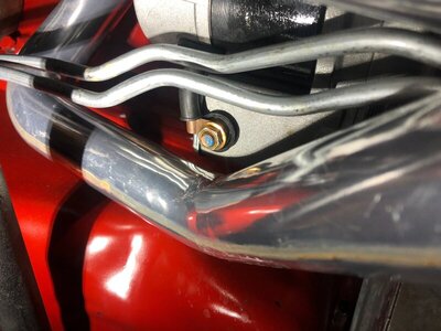

The is a new configuration. I've got a new 318 rebuild and I'm working out the kinks from a new startup last Sat. Things are looking good, but I notice once the engine is warm I'm getting an spark jumping from the starter (new mini from for a 92 Dakota) to the header pipe which is really close, less than a finger width. See attached pictures.

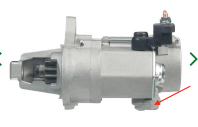

The starter picture shows the connector that is arcing the pipe.
I checked for voltage at this connector with key on and off, none. I'm guessing after the engine and header pipe heats up the clearance closes enough for the spark to jump. When this happens I can't start the car, I just get the relay chatter. Once it cools I'm good to go.
Am I not grounded somewhere? I removed the insulator that came on the starter, it appears to be made of rubber not sure.
Suggestions?

That boot is usually made of silicone rubber and should withstand the header heat.

The spark was arcing through the boot, it was lightly touching the header pipe, that's why I removed it.

Ok, I tried the suggestion about hooking up a jumper cable between the transmission housing and Neg battery. Well, I did that, still I'm getting chatter when I start when warm. Maybe I got a bum starter, it's still under warranty...

I ran an extra ground strap from the starter bolt to the bulkhead and I replaced the starter relay. Same results, once it get good and hot I get chatter until things cool down and then I'm back to normal. I tried again to see the arcing between the starter lug, and the header pipe but couldn't, so I don't know what's going on.
