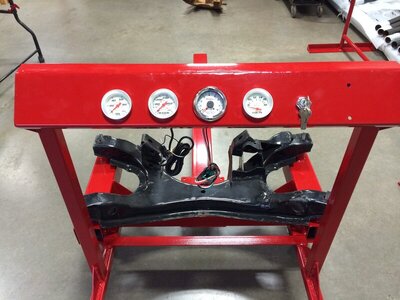

Rather than build both, an engine run stand and a k frame engine, trans mobile stand for installing from underneath…….Has anyone made a mobile steel framed K frame stand that dual purposes as an engine run stand and installation stand?
Obviously the radiator/gauge panel frame would need to be removable
if so and you have some pics that would be appreciated

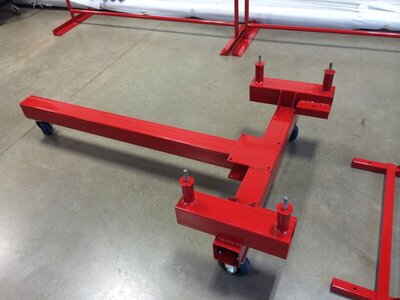

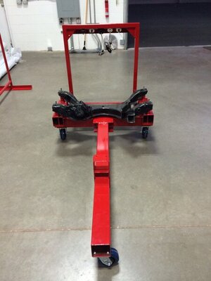

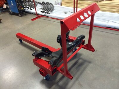

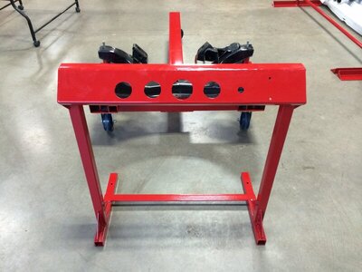

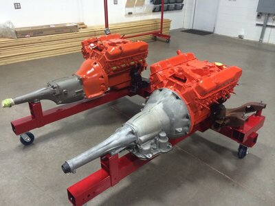

I planned to build one of those but been too busy. I looked at a lot of different ones but I like this one.
image (1).jpeg image (1).jpg image (2).jpeg image (3).jpeg image.jpeg image.jpg
Excellent much appreciated Stanton
I was thinking of making one higher off the ground as I have a car hoist and to aid in the installation, probably still need to use a creeper trolley though

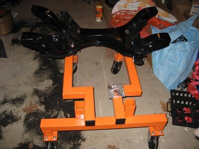

That's how many of these K frame stands are. I guess they still expect you to pick the engine up with a jib hoist to pull it up into place.. which is just stupid. Mind you it sits so low you probably couldn't lower a hoist that far down to work anyhow.

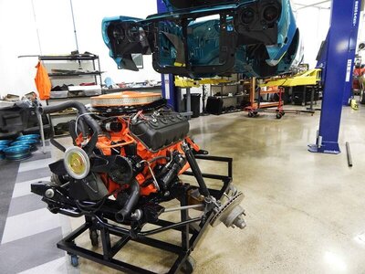

I think you could easily adapt it to run an engine on it if needed. I used it to install an engine in the bee today.
I built one like the beekeeper, but

I built one like the Beekeeper and used it once. If your interested I'd sell it to you, if we can figure out how to ship it. PM me if interested and I can send you some photos..
