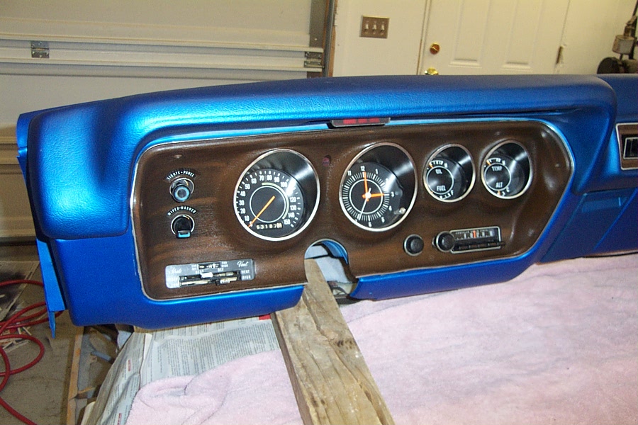

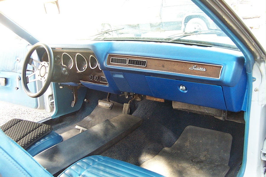

I used a silver paint pen from Office Max in my 72 beater

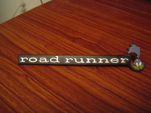

I got a Krylon Silver Leafing pen with wide beveled edge, here is what my Roadrunner dash emblem looks like.
Now if i could only figure out the correct colors to return the brightness to his faded face!
