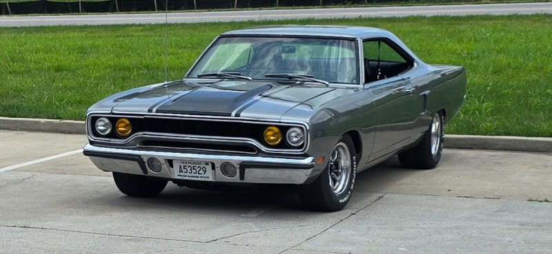

My 70 satellite was originally a 318 auto car. Now its a 440 auto. Im using -2 espo springs with dropped front spring hangars and leaf sliders in the rear. The car rides and handles well. I doubt it will ever see the track. Im using a stock non adjustable pinion snubber. With no issue's.
Nice! Your stance looks perfect! I assume the “-2” means a 2” lowering spring in the rear? I looked up Espo Sorings and they show that the B body springs for 440 are discontinued????
Yes the -2 is a 2 inch drop spring. I bought these a couple of years ago. I think there is another supplier that may have them. I dont remember the the name but im sure someone else will chime in with the info.
